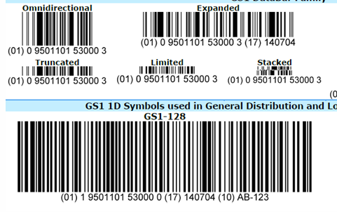

Just to speak to some of the barcoding here… 043Y, 1S and S are all identifiers used in barcodes like GS1 standards for example. Them being missing on the human readable part is unfortunate. However, they are expected to be programmed around, and lots of larger companies use these codes to identify separate data in a single barcode.
Your best chance of understanding the coding from the company is going to be their documentation. You’d expect Cummins would be large enough to have this information for you, but you know what they say about assumptions.
As seen in this image, you can have multiple identifiers per barcode, so you know where the data belongs.
@zachg brings up an excellent point. If your supplier is set up using GS1 standards, then your company should be using GS1 standards. If you are a member or GS1 (or whatever the organization is called), all of the information required for breaking down another companies barcode is available.
