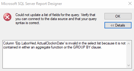

Here is the Query with the statement you suggested.
SELECT Erp.LaborHed.ActualClockinDate, Erp.LaborHed.DspClockInTime, Erp.LaborHed.DspClockOutTime, Erp.LaborHed.EmployeeNum, Erp.LaborHed.LaborHedSeq, Erp.LaborHed.PayHours, Erp.LaborDtl.ClockinTime,
Erp.LaborDtl.ClockOutTime, Erp.LaborDtl.IndirectCode, Erp.LaborDtl.LaborHrs, Erp.EmpBasic.JCDept, (CASE WHEN SUM(Erp.LaborDtl.LaborHrs) > 40 THEN 40 ELSE SUM(Erp.LaborDtl.LaborHrs) END) AS RegularHrs,
(CASE WHEN SUM(Erp.LaborDtl.LaborHrs) > 40 THEN SUM(Erp.LaborDtl.LaborHrs) - 40 ELSE 0 END) AS OvertimeHrs
FROM Erp.LaborHed LEFT OUTER JOIN
Erp.EmpBasic ON Erp.LaborHed.Company = Erp.EmpBasic.Company AND Erp.LaborHed.EmployeeNum = Erp.EmpBasic.EmpID LEFT OUTER JOIN
Erp.LaborDtl ON Erp.LaborHed.PayrollDate = Erp.LaborDtl.PayrollDate AND Erp.LaborHed.LaborHedSeq = Erp.LaborDtl.LaborHedSeq AND Erp.LaborHed.Company = Erp.LaborDtl.Company AND
Erp.LaborHed.EmployeeNum = Erp.LaborDtl.EmployeeNum
WHERE (Erp.LaborHed.ActualClockinDate > @StartDate) AND (Erp.LaborHed.ActualClockinDate < @EndDate)
When I try to save it I get this message.
I still get the “Define Query Parameter” message box and then this.

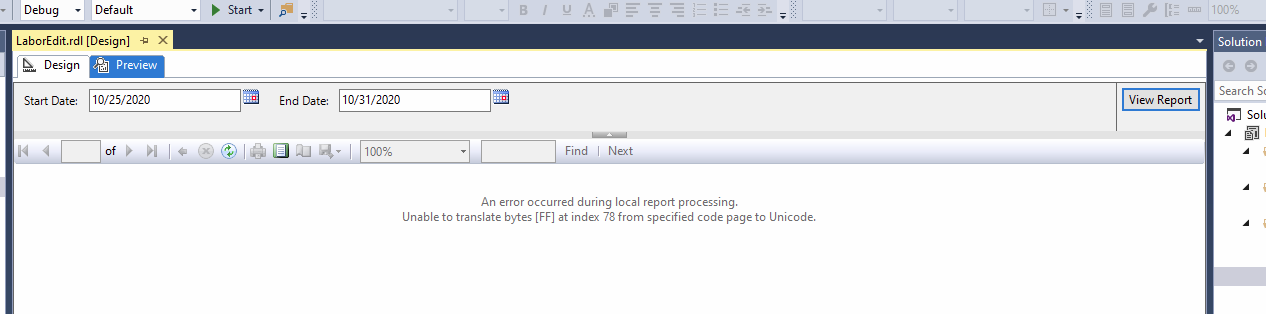

Query saves now but I get an error when the report is run.
What data type are your parameters?
Date/Time
Are you able to run the query in SSMS?
Never seen this error. Could it be a visual studio issue?

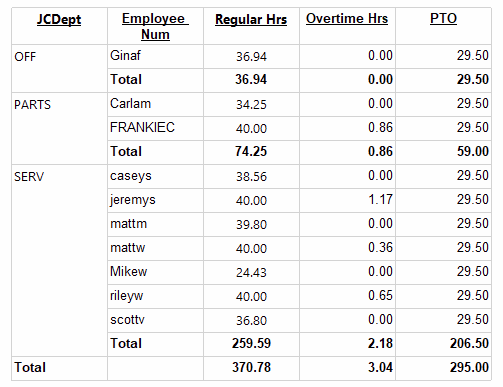

So after working on this I am able to run the query in Visual Studios but my PTO total is pulling from the sub-query as the grand total for the report. Each line is showing 29.5 but that is the over all total.
Here is my query.
SELECT T1.EmployeeNum, (CASE WHEN SUM(T3.LaborHrs) > 40 THEN 40 ELSE SUM(T3.LaborHrs) END) AS RegularHrs, (CASE WHEN SUM(T3.LaborHrs) > 40 THEN SUM(T3.LaborHrs) - 40 ELSE 0 END) AS OvertimeHrs, T2.JCDept,

At no point in your inline subquery did you link it back to the main. You linked the tables inside of the subquery to the tables in there, but not back to the main dataset.
In your subquery where statement add the below. Assuming employees aren’t working in multiple companies.
WHERE T1.Company = S1.Company AND T1.EmployeeNum = S1.EmployeeNum
Also side note, your current subquery WHERE clause could be simplified to:
WHERE S1.ActualClockinDate > @StartDate AND S1.ActualClockinDate < @EndDate AND (S3.IndirectCode IN ('PTEN', 'PTPO', 'PTPD', 'PTSR')

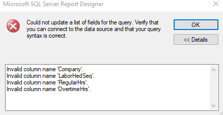

I tied the IN statement and couldn’t get it to work.
Adding either of these statements causes an error when I close the Query Designer.
The fist statement causes this error.
Invalid column name ‘EmployeeNum’.
Column ‘Erp.LaborHed.Company’ is invalid in the select list because it is not contained in either an aggregate function or the GROUP BY clause.
