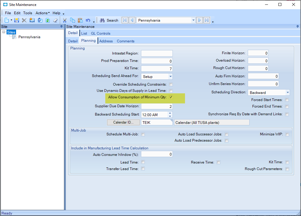

@msoni, One other thought. There is a setting for “Allow Consumption of Minimum” which, if turned ON, the system will not make a suggestion if there is already a PO that is WITHIN THE LEADTIME of the part and the qty of the PO will take you above the minimum.

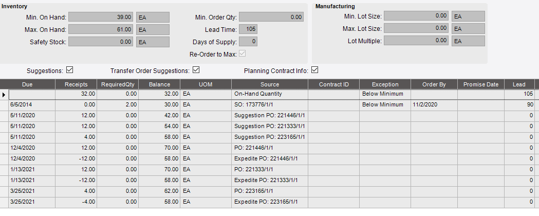

Here is an example of a part that I don’t see it creating a suggestion correctly. Unless I am counting wrong.

We have used reorder to max in the past. A couple of thoughts… Your dates are very old, I would test with dates that are believable. Bad dates give bad results frequently. Also, if you would like the system to combine the PO suggestions and demands, use a days of supply value. If you cannot change a cut PO, consider locking the PO release quantity and date, then you’ll get less noise on expedite or increase qty suggestions. From the looks of it, you’re treating MOH like SS. Do you want the system to work to never go below MOH, similar to SS, or allow consumption of minimum on hand as normal procedure?
There’s a setting in site maintenance for it, per sceenshot. Finally, is there usage of the part in between the MRP run and your screenshot? 58 is fairly close to 61…

Posted a screenshot. Please let me know what you think.
Also, 2014 is an open PO that got carried forward when we migrated to Epicor from our old system. There are several parts that migrated with open PO’s which may have been received but never got closed on the system. That is definitely another issue which we are not sure how to tackle given that we have over 100k parts on our system. Having said that could definitely be messing with our suggestions generated. Thoughts?
I believe it is working 100% as it “should” based on the dates…
  1. your current qty is “Below minimum” (see exception column). This will trigger the system to pull in a PO.
  2. you have a demand on 6/5/2014… this futher drives you below the minimum. You now only have 30 projected in stock on 6/5/14
  3. you have Reorder to Max…
  4. The system sees your 3 PO deliveries in the future for 12, 12, and 4 (28 total pieces).
  5. it “suggests” that you reschedule all three of those to 5/11 (probably the date you ran MRP, or the date you have as your MRP start date).
  6. it is not suggesting that you purchase anymore, because your current supply is above the minimum.
    to demonstrate this:
  • you could cancel the three PO’s and you would probably see a new suggestion to purchase 33 pieces (61-28).
BUT in times like this. I tend to suggest the data be corrected.
  • Fix the sales order date. Make it realistic
  • confirm that the POs are correct
  • confirm that the Lead Time is correct
