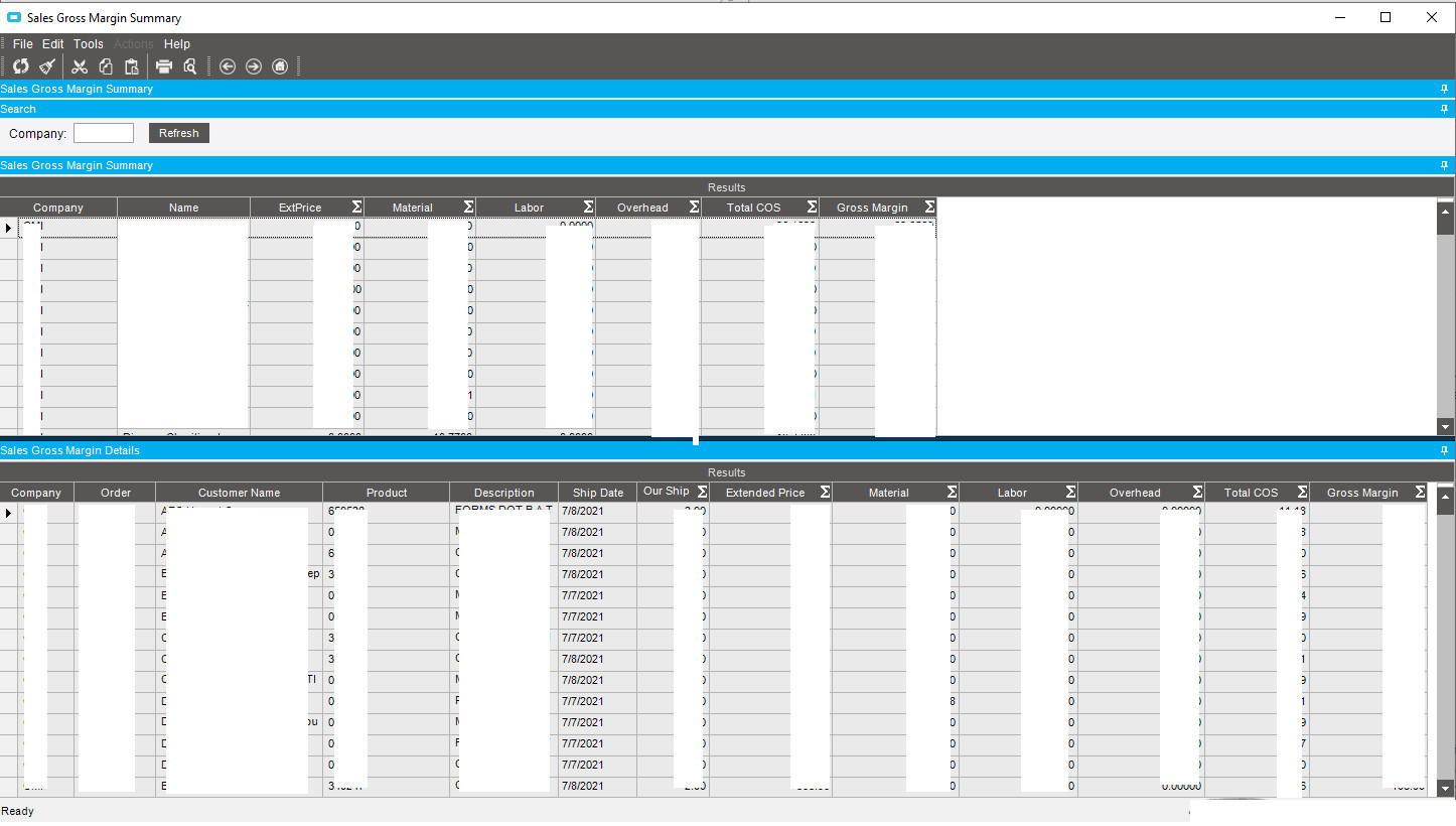

I have included a picture and the current code.
Please look it over and let me know if there are any questions.
The first thing is when you open the dashboard, it pops up the parameters for the first BAQ (Top grid). It is Start Date and End Date so that the first BAQ can run calculations on the filtered results.
The first BAQ id called: Sales_Gross_Margin_Summary
The Second is called: Sales_Gross_Margin
I have published 2 fields (Start Date and End Date) from the top grid and filter by them in the bottom grid to make sure the data is showing the same date range in both.
The search box ‘Company’ Filters both BAQs at the same time when someone types in the box. If they type something that causes the rows to be blank, it will pop up and tell them, then delete the last character typed and filter by that.
The refresh button is supposed to select the top grid and do a refresh. That will cause the BAQ parameters to pop up so you can select a new date range.
The reason for the line that tries and selects the 1st row in the top grid is because if the bottom grid is selected, the refresh does nothing.
Below is an image of the dashboard with most of the info deleted.
Below is the code I created to try and do what I need it to.
