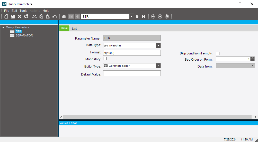

  1. Create a BAQ parameter: STR to hold the value to be split (e.g. ‘1,2,3’). Set FORMAT to x(1000) or as long as the longest string you expect.
  2. Create a BAQ parameter: SEPARATOR to hold the character (e.g. ‘,’ )

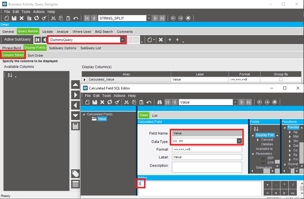

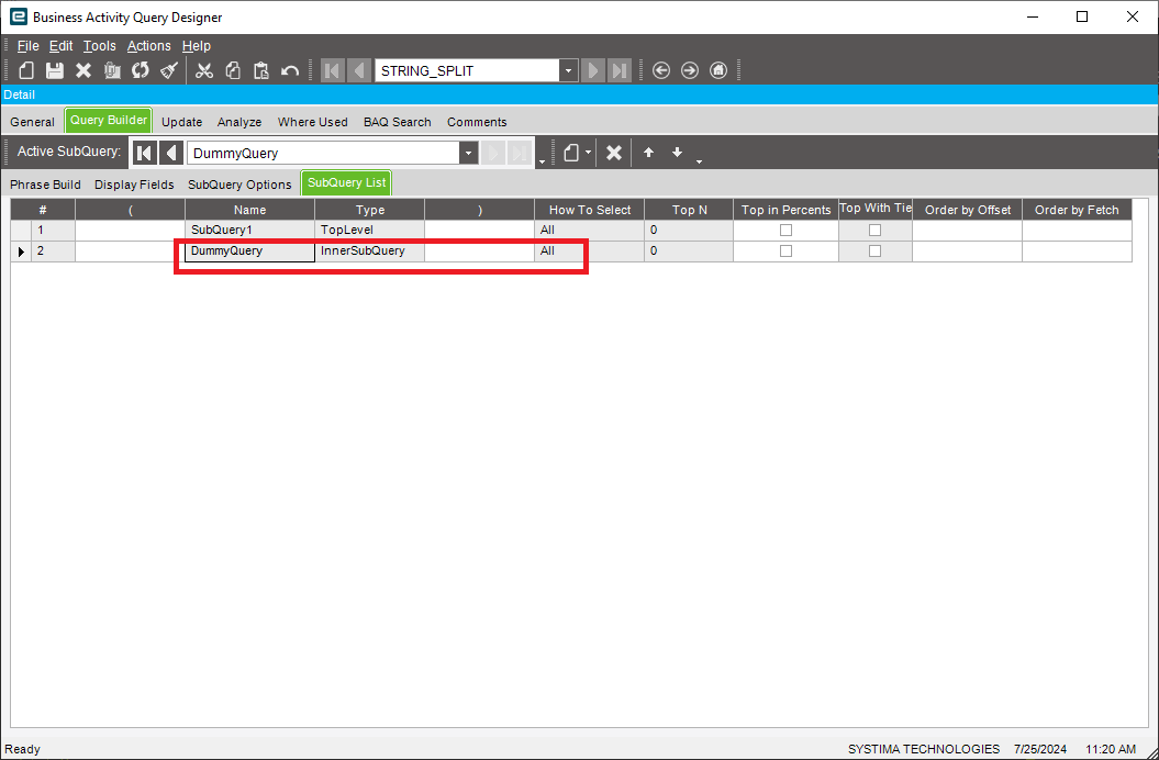

  3. Create an InnerSubquery called DummyQuery
  4. Create a calculated column in DummyQuery. Calculated_Value = 1

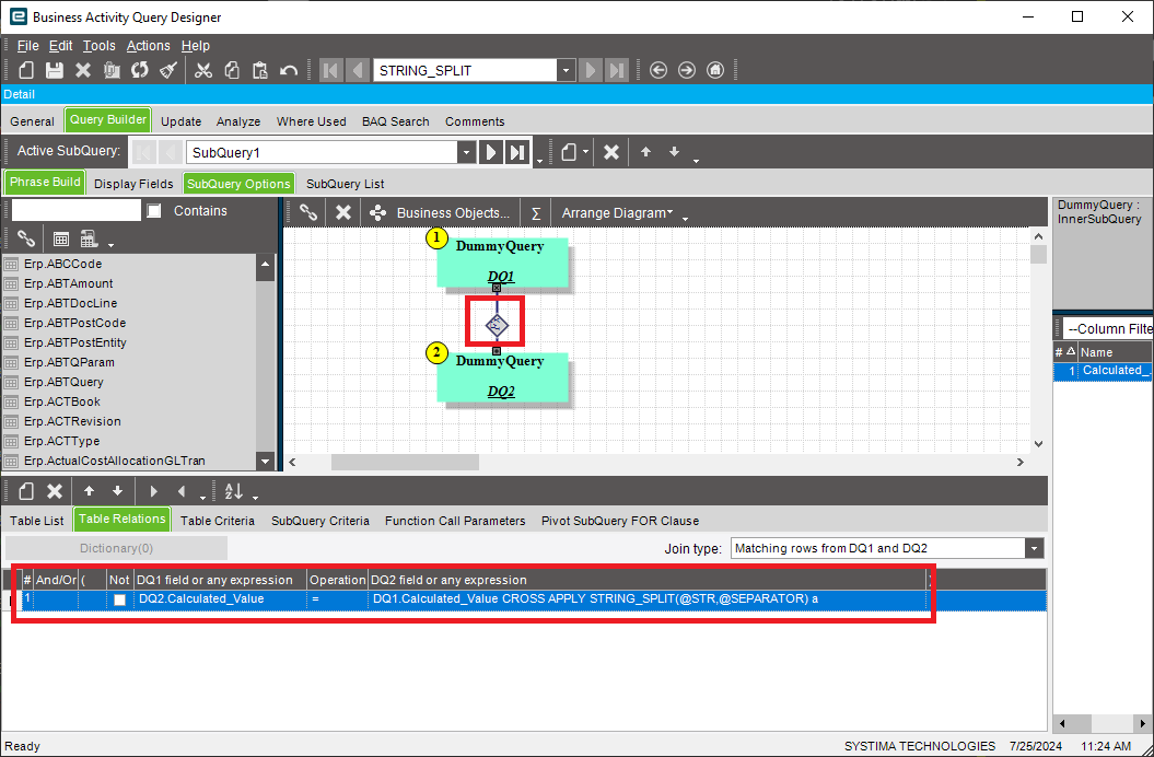

  5. In your top level query, create 2 DummyQuery blocks. Call them DQ1 and DQ2.
  6. Create a table connection from DQ1 to DQ2. It’s very important you do from DQ1 to DQ2.
  7. In the table relations tab for the connection, enter the following:
    DQ1 field or any expression: DQ2.Calculated_Value
    Operation: =
    DQ2 field or any expression: DQ1.Calculated_Value CROSS APPLY STRING_SPLIT(@STR,@SEPARATOR) a

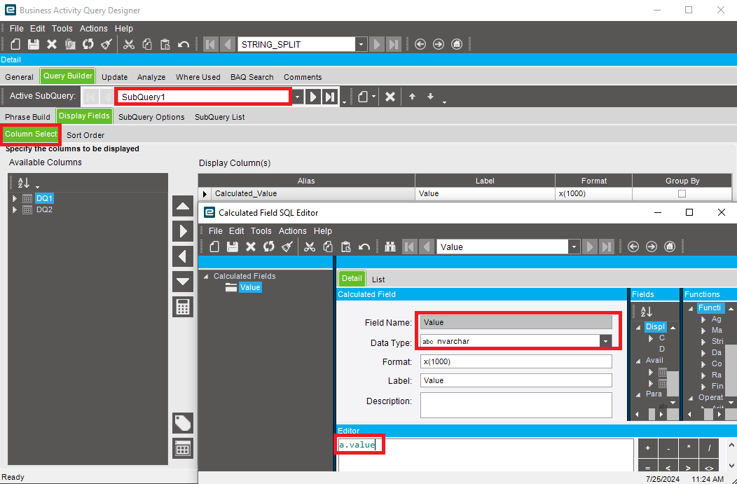

  8. In your top level query, create a calculated column.
    DataType: NVARCHAR(1000).
    Expression: a.value

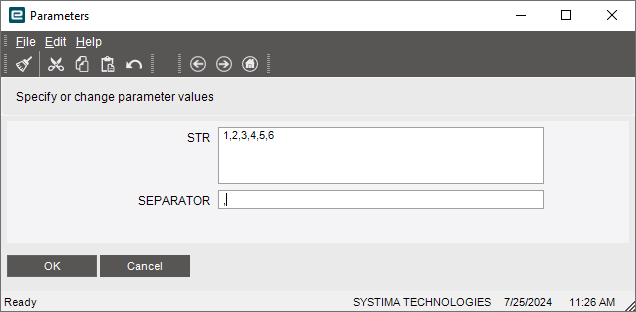

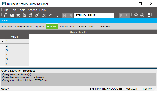

When you run, test with these parameters:
You will get:

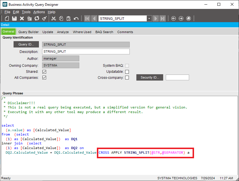

You can see, using these steps we’re tricking Epicor into adding a CROSS APPLY to your joins list.
The dummy queries really are just that- dummy’s I needed so that we could sneak in the CROSS APPLY in the join condition expression.
