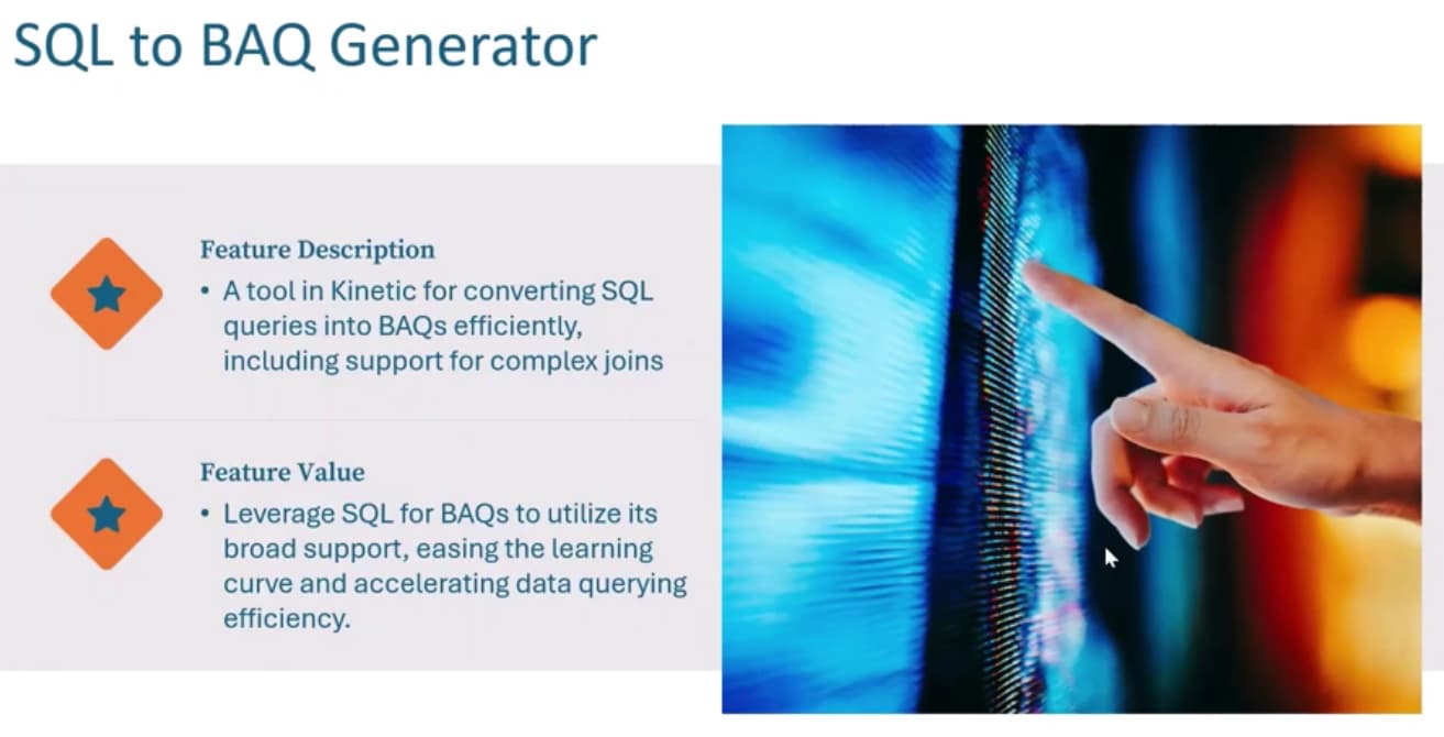

I am going to drop this here as a reminder that we ARE making some really cool features that you have always requested. This feature is coming with Kinetic 2024.2 The image below is from the Feature Spotlight video that everyone will be able to view as part of our release.
Here is one of the great new features (also referenced here: Is there a way to create a BAQ from its SQL code? )
This was in Epicor Ideas with 84 votes: Log In - Epicor Identity

initially it was going to be done with prism, but instead, we were able to do it without prism I believe. It is “simply” back engineering the BAQ. Once it generates the BAQ, it still uses all the normal BAQ security, applying whatever user security the user has, so just because you can create a SQL Query doesn’t mean you can override core security features.

well, in a way, with this new feature, you will be able to do that, but not directly. Since BAQs already show you a SQL Statement, you can copy that, edit it, and then paste it into a NEW BAQ. We just are not allowing you to edit it directly in an existing BAQ. I am sure that someone will make an Epicor Idea for that one someday :wink:
Agreed but like you say, import it into a NEW BAQ, which means if you have a dashboard or something connected to it you need to update that to point to the new BAQ, would be nice to be able to update the existing one through the import, or just make it directly editable.
Don’t get me wrong, I love this feature, just would be nice to be able to directly edit the code being produced by the BAQ, it is often nice to start with the GUI of the BAQ and then switch to code to refine it.
The workaround for that would be to import is as the same name, and it will connect fine (you have to delete the original BAQ first).
I’m assuming the “Generate from SQL” command is making a lot of assumptions/defaults with the extra data that’s need to save a BAQ and updating it with just the SQL is probably not going to save that info if you’ve changed anything so they disallow it. Kind of like when you “Customize” a tracker view in the dashboard editor (Which I argue you should never do)
