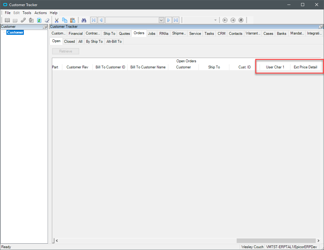

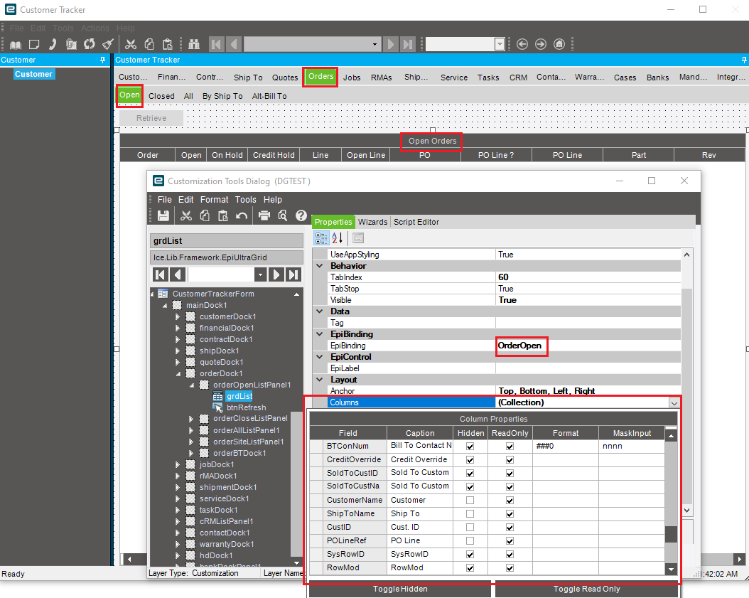

The first step is to add the custom columns to the grid.
Code for adding columns to the Grid
Here all I’m doing is adding the column headers to the grid. At this stage, this is basically meaningless as the columns won’t be populated. However, you should see 2 new columns in Customer Tracker > Order. You shouldn’t need to add any using statements at this stage - just grab the EpiUltraGrid and add the two columns. We’ll fill these in later.

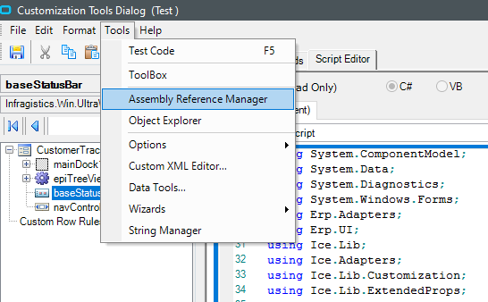

Now that we have added two columns, we can fill them with data as the grid populates.

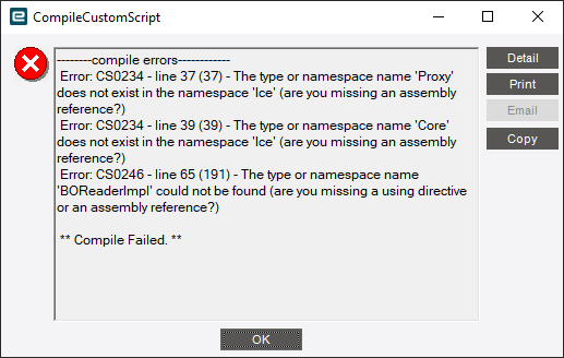

This more directly deals with the error message you sent over.
Populating the Grid Part 1

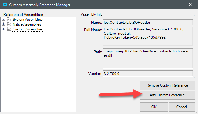

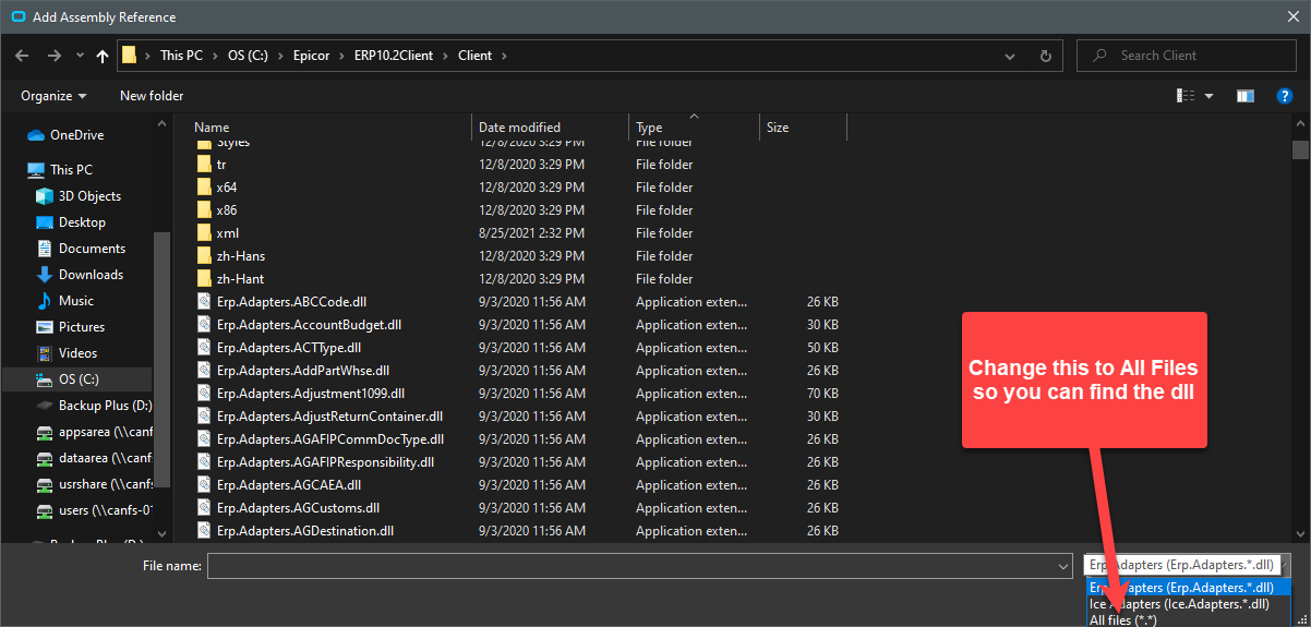

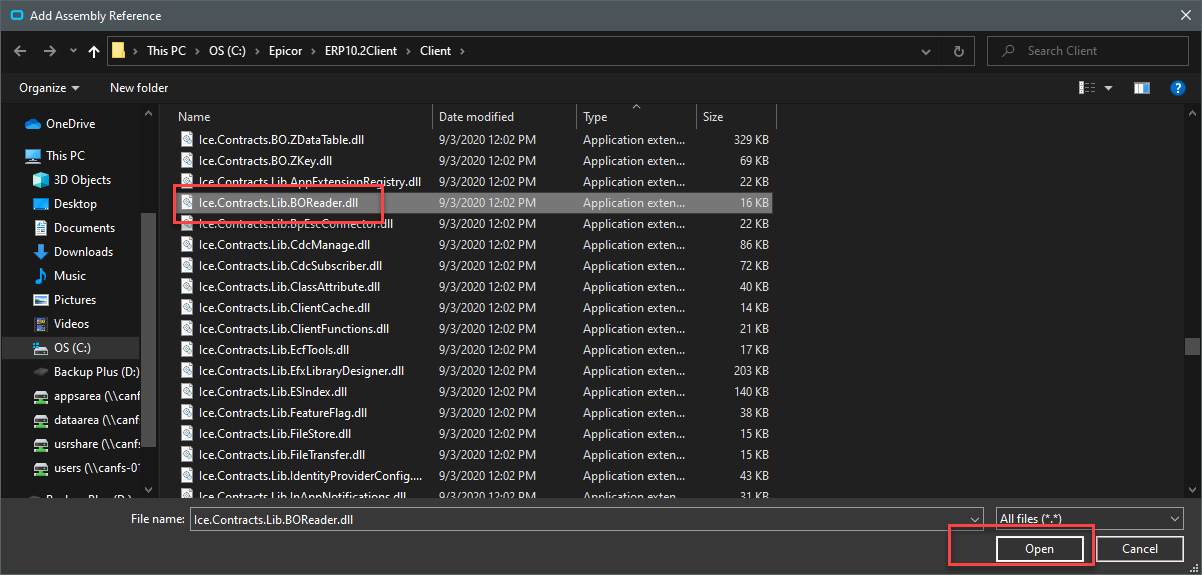

First, we need to add an assembly reference to the “Ice.Contracts.Lib.BOReader” dll
Now that we’ve added our assembly reference, let’s define the BOReader object we’ll use to populate the added columns
