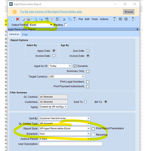

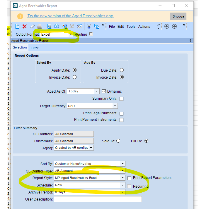

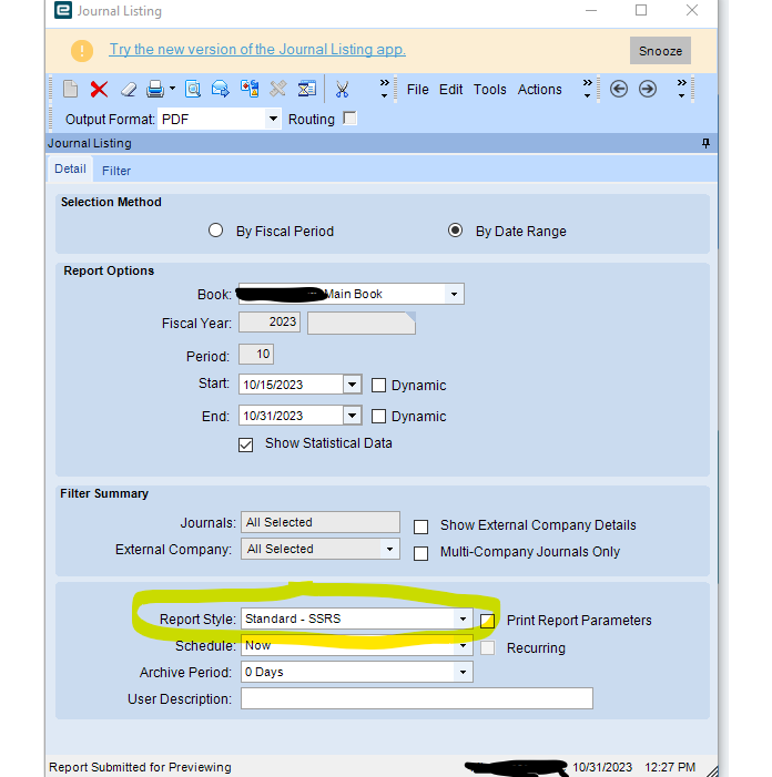

But, I’m not sure I need too much more work if the Report Style is already set up for another report!? See below. We already have MP-Aged Receivables-Excel set up as a Report Style for the Aged Receivables Report. We use it and select the Output Format as Excel to export the data. How do we add this Report Style to the Journal Listing and then we’ll select the Output Format as Excel to export its data?
You’re talking about two totally different reports. You’ll need a new style in the “Journal” report style which is style ID: Journal (AR Receivables style ID is: ARAgng). You’ll likely need someone who knows SSRS to design as I doubt Epicor’s Standard - SSRS version of the journal will export cleanly to Excel.
