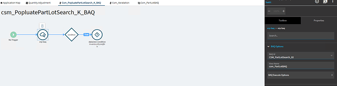

Yep for now. Can I use Parameters and filter it from BAQ itself if there is a chance? Let me know how to do that, please. I am using your second method from this post. Also, to test the current config. I filter it with part which I am using it for testing. Part: 60000. It has 154 rows but when I filter it with all the filters I am using in my application. It filters only required rows.

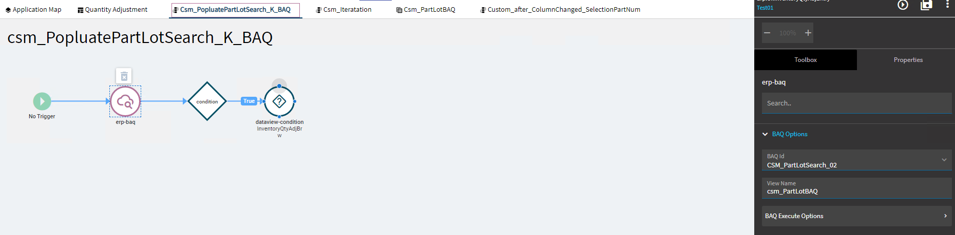

This is how I mapped BAQ with view
I wouldn’t do them both at the same time. Load the full BAQ dataset up front after the GetByID event.

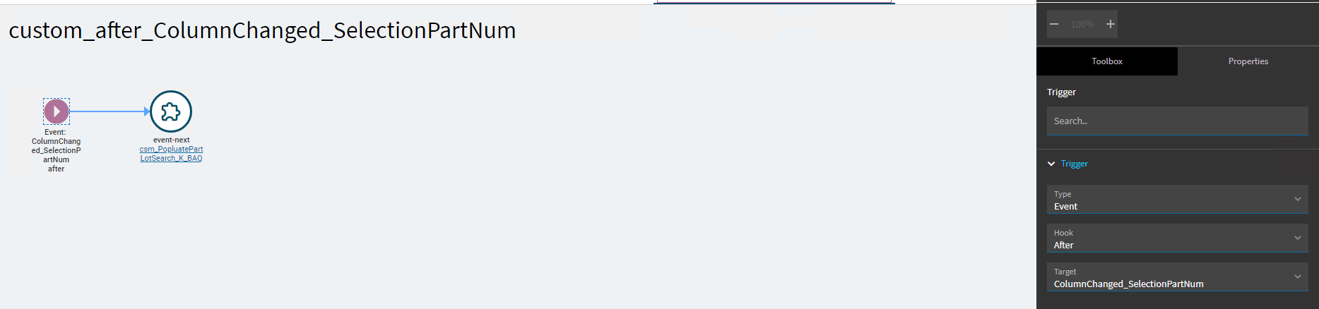

Qty Adjustment doesn’t use GetByID. Instead, I used the below one. So your suggestion is to use erp-baq node here itself rather than calling the event next?

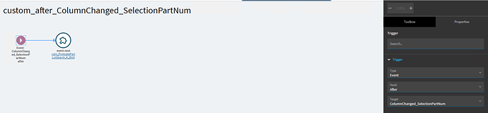

This one used, Instead of GetByID:
This is the next event

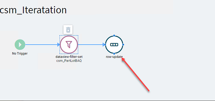

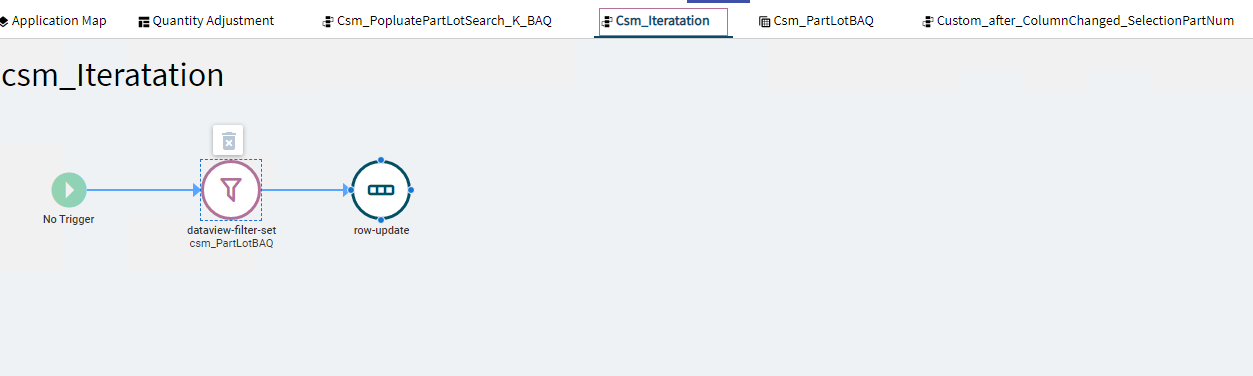

this is for iteration

There’s some speculation about whether we need to add some new widgets to the iteration event. @aosemwengie1 discovered that if you add the column, the view triggers the hasChanges property on the view to true and tries to call an update on the unchanged view and barks at ya.
To fix it, you need to add some widgets before and after the row-update widgets. (Bold is new)
event-row-disable > row-update > dataview-commit > event-row-enable
