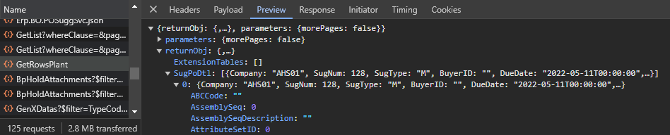

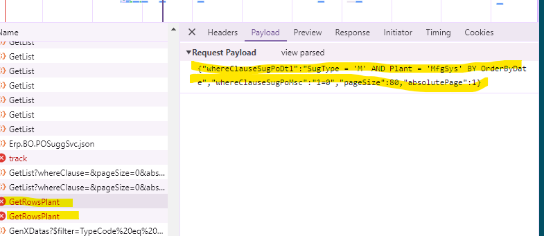

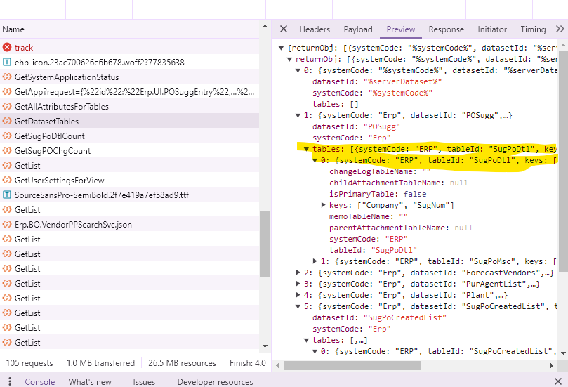

Ok, I see. Now the issue is the method. I’ve done a trace and it looks like the table that I need (SugPoDtl) is being pulled in through GetDatasetTables with a few others. Is this the method I should modify?
That looks like it’s building the dataviews for storing the data for the page.
I would suggest looking at the GetRowsPlant method that has the data for the grid:
So then you go create a BPM for Erp.BO.POSuggSvc/GetRowsPlant

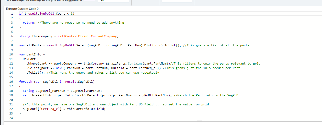

You can try something like this in a custom code widget in your BPM:
if (result.SugPoDtl.Count < 1)
    return; // There are no rows, so no need to add anything. Do nothing.
string thisCompany = callContextClient.CurrentCompany;
var allParts = result.SugPoDtl.Select(sugPoDtl => sugPoDtl.PartNum).Distinct().ToList(); // This grabs a list of all the parts in your suggestions
var partInfo =
    Db.Part
        .Where(part => part.Company == thisCompany && allParts.Contains(part.PartNum)) // This filters to only the Parts relevant to your grid
        .Select(part => new { PartNum = part.PartNum, UDField = part.ShortChar02 }) // This grabs just the info needed per Part
        .ToList(); // This runs the query and makes a list you can use repeatedly
foreach (var sugPoDtl in result.SugPoDtl)
    string sugPoDtl_PartNum = sugPoDtl.PartNum; //
    var thisPartInfo = partInfo.FirstOrDefault(pi => pi.PartNum == sugPoDtl_PartNum); // Match the Part info to the SugPoDtl
    // At this point, we have one SugPoDtl and one object with Part UD Field ... so set the value for your grid:
    sugPoDtl["MyUDField"] = thisPartInfo.UDField;
Let me know if you have any questions. I didn’t actually test this, just patterned it after another BPM I have

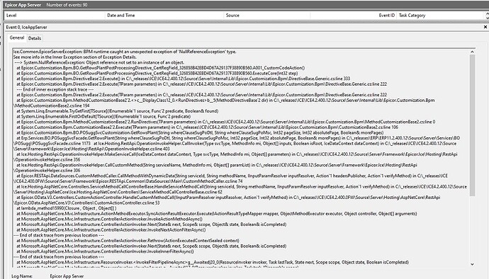

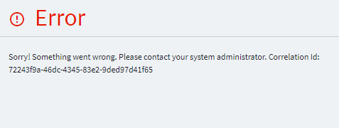

Jonathan I finally got time to try this. Unfortunately, when i run the PO Suggestions now, I’m getting two errors. Both look like this:

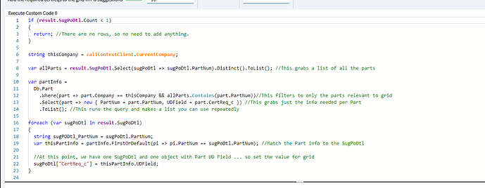

Here is the custom code:
Not sure what I’ve done wrong or missed. Code compiles fine.

Here is a snippet from the server as well.
Ok, never mind. I was able to get the errors resolved. Sorry to bother.

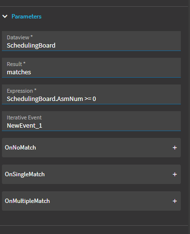

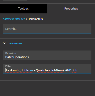

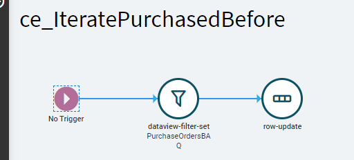

I followed these instructions but still am not seeing it populate into the grid. I see the matches.{field} get updated in the row update with the value but I am not seeing it populate in the grid. I added JobMtl_PartNum into the SchedulingBoard dataview.
Filter the BAQDataView:

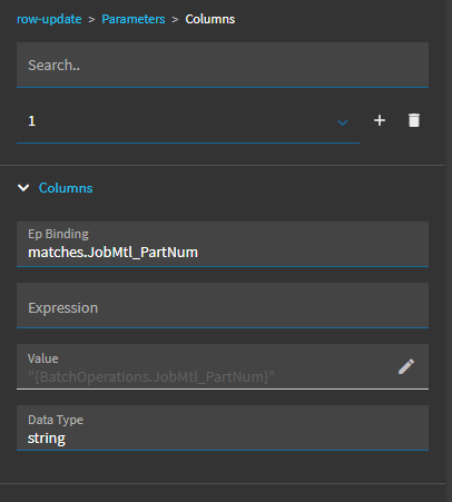

Updating the added column in the schedulingboard data view with the BAQDataView:

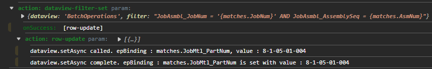

We see it filters and does a row update:

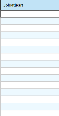

Nothing populated:
This field is set to SchedulingBoard.JobMtl_PartNum. Should the EPBinding be set to something else??
Nevermind :man_facepalming: needed to add the column field as the field name on the dataview not the ep binding… Thanks!

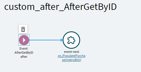

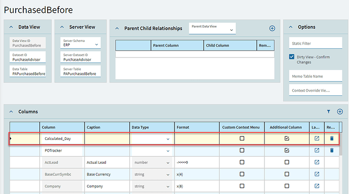

My BAQ View is not getting any data. What am I missing?
I imagine you’re missing an event to populate your view.
I have all the right events and such
I am trying to do this on the purchase Advisor screen

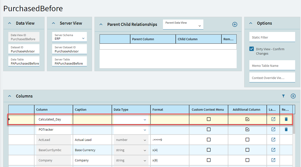

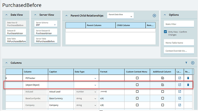

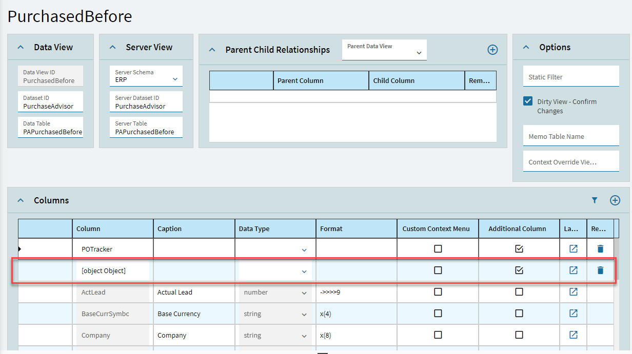

I don’t even see my new column that I added to the data view
I closed the browser and went back in and now my column in the dataview is just an object. Why would it do that.
The column I am trying to add is a calculated field from the BAQ (Calculated_DaysLead)
