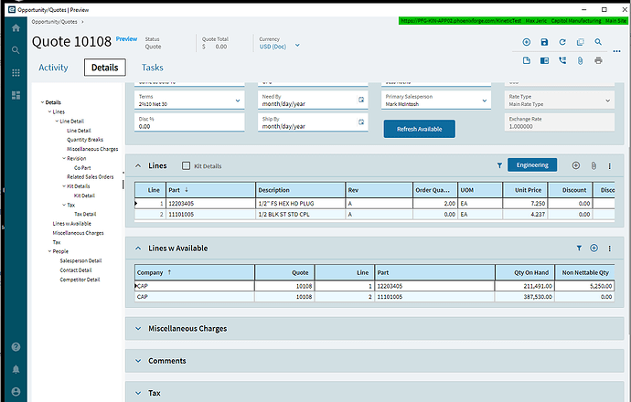

What happens is when I add the BAQ fields to the QuoteDtl columns , polulate and iterate , the QuoteDtl view always comes back blank. I have but in dialogs during testing confirming successful events. Have add a BAQ view to display the BAQ results confirming they come in. It seems to be in the ROW update that it fails. Also during the datview-filter in the iterate event, loose all the records in my BAQ view as well. Debug after the events shows records in the QuoteDtl and matches view. But none displayed on the QuoteDtl form view.

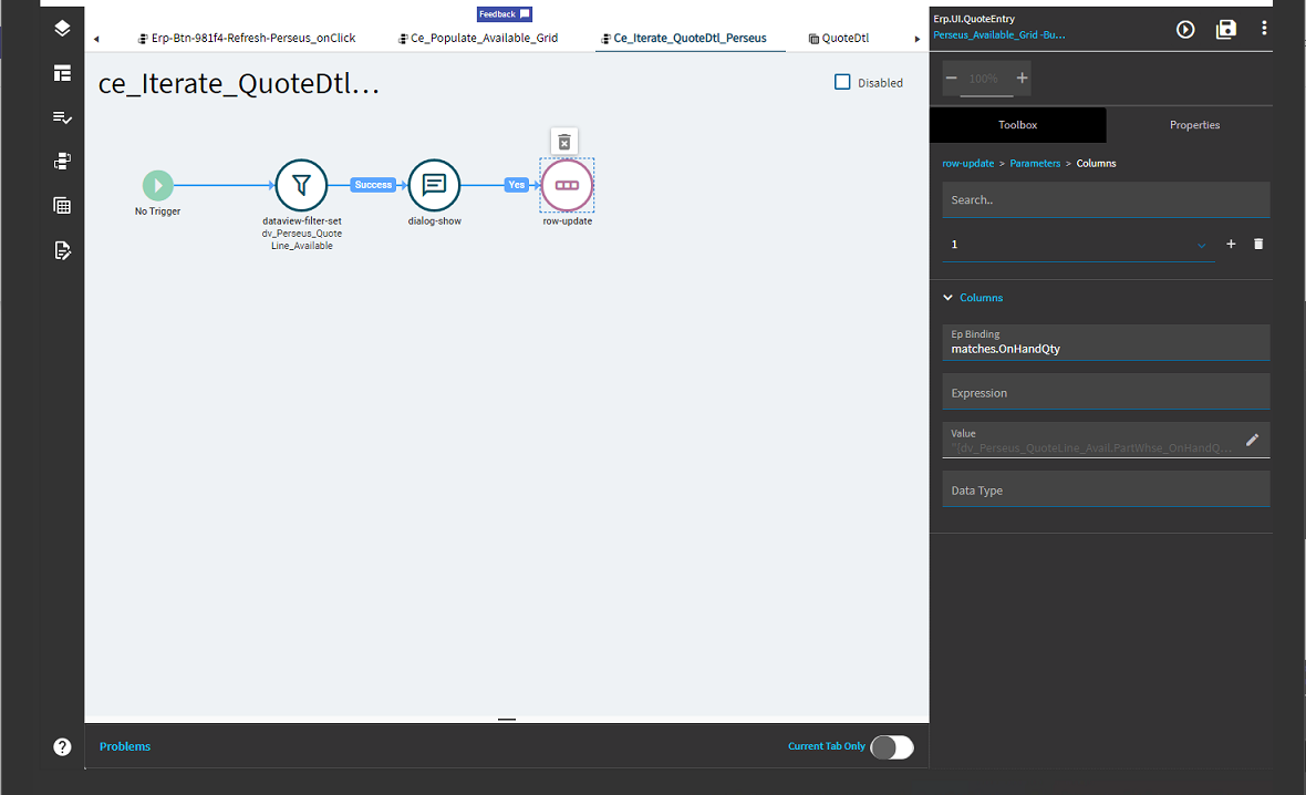

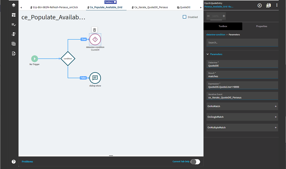

Added Grid Panel under lines to test display of my BAQ view. Added a Refresh Available button to isolate the Populate and Iterate events, hooked the populate event to it. Loose all records in display of both QuoteDtl and my view after click…

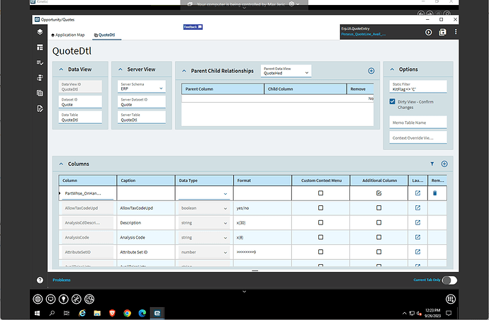

Can you try on a new layer, to just add the column, and post where you added it so we can see?

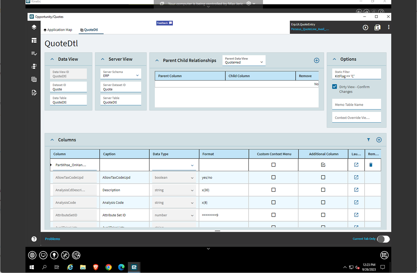

Added PartWhse_OnHandQty from my BAQ to the default QuoteDtl view.

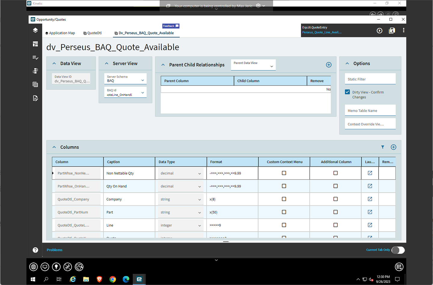

This is the view from the BAQ.

I recreated everything from base. Exactly like the writeup. Tied it to a menu item. Same thing. Lines show up empty. ver: 2023.1.10
When you say that, how far did you go?
Did you just add the fields, or did you go further?
Created the view for my BAQ, added the BAQ field in QuoteDtl view, created the Populate and Iterate events, added the Populate event to the After GetByID event.
Just add a field to the view, don’t do anything else. See if it still populates.
Tried to step through each addition to solution. Stops painting the QuoteLines after I added the BAQ field to the system QuoteDtl view.

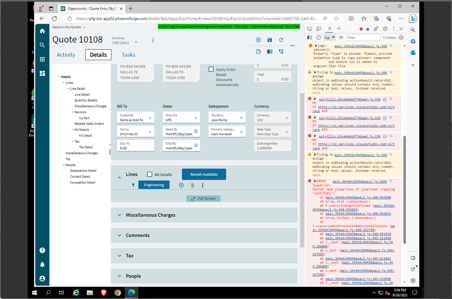

Any movement on this? Also seeing the same issue on a 2023.2 Pilot environment. Soon as a column is added to the OrderDtl Dataview, no lines shown at all.
ERROR TypeError: Cannot read properties of undefined (reading ‘epStrEqCi’)
at main.4a96d25cee4d977e.js:348:593736
at Array.find ()
at p.overwriteCaptionFormat (main.4a96d25cee4d977e.js:348:593720)
at main.4a96d25cee4d977e.js:348:593643
at Array.forEach ()
at p.overwriteExtPropsWithAdditionalColumns (main.4a96d25cee4d977e.js:348:593626)
at main.4a96d25cee4d977e.js:348:592665
at main.4a96d25cee4d977e.js:345:211562
at c._next (main.4a96d25cee4d977e.js:345:207702)
at c.next (main.4a96d25cee4d977e.js:345:197300)
at main.4a96d25cee4d977e.js:345:211555
at main.4a96d25cee4d977e.js:345:215383
ERROR TypeError: Cannot read properties of undefined (reading ‘model’)
at cg.initializeLoader (main.4a96d25cee4d977e.js:348:1216109)
at main.4a96d25cee4d977e.js:348:1212938
at S.subscribe.R (main.4a96d25cee4d977e.js:345:215102)
at c._next (main.4a96d25cee4d977e.js:345:197612)
