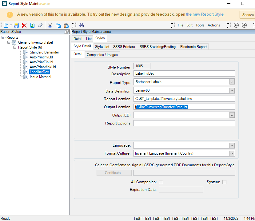

If I use this for out file: C:\BarT\InventoryTransfer{Date}.bt
I am getting : InventoryTransfer20231103.bt for file.
Is there no other way, like using a JobNum to replace it with date?
THanks
Unfortunately I’m not well versed enough in SSRS to know for sure. I’m guess that those tokens are just generic ones and not ones specific to the data you are sending.
