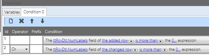

With contemplating on how to process labels in E10 in reference to Bartender. Currently I am trying to avoid the standard data directive method with autoprint to generate Bartender labels (since there is a small set of labels built in). I have been attempting to use a standard data directive with a simple condition to utilize custom code as an output “BT” file for Bartender to pickup and print the correct label with data associated from the code. Currently I think my issue now is the codes missing “report parameters” similar to the auto print function. But I don’t know how they would look in C# code??? (Code was provided from an older version of E10)
