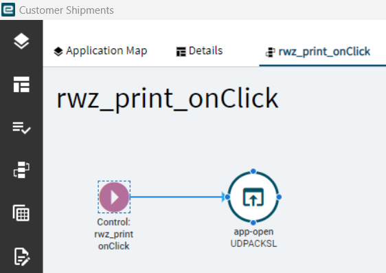

Below is the button click event that I have to launch the Epicor Packing Slip which works great!
I just need to add the auto print preview to PDF events without bringing up the BAQ report form for the other 3 BAQ reports.

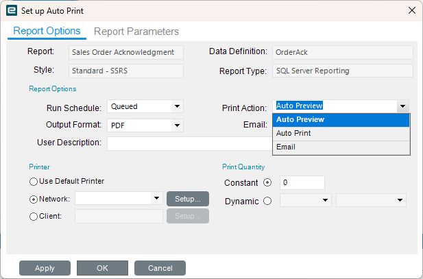

As soon as I sent the previous message, I also thought about the Auto Print widget in a Standard Data Directive. Use a standard data directive that fires on the Pack Slip print. You’ll need to distinguish this print from any other print… perhaps use the User Description field. I’ve done this in Kinetic to auto print a Job Pick List when printing a Job Traveler. It works.
Three addition reports to preview? Following on @dr_dan you could addin multiple auto print widgets for the other reports on the back of the pack slip print. You can use the autoprint flag to trigger it, using the auto preview option

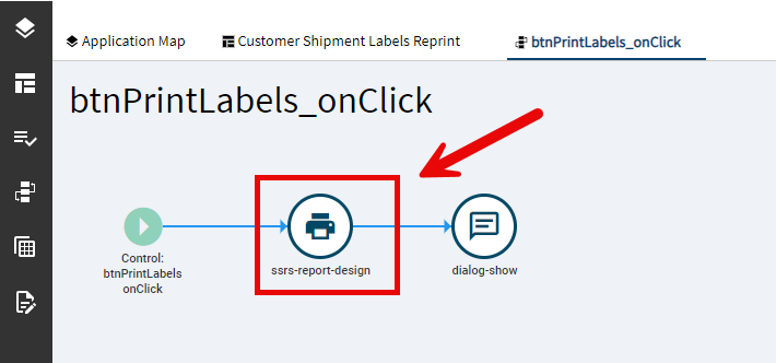

Does anyone have any experience using this widget in Application Studio? I’ve searched on the documentation and online, but haven’t found any information.
According to its name sounds like its just executing the for design option rather than the actual print… IDK. Doing labels for bartender might be worth looking at the REST API… There are posts on it
