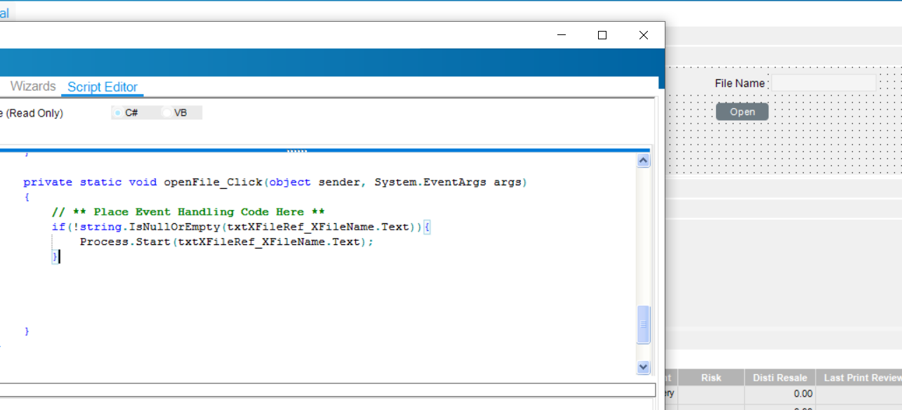

Attempting to call it from a dashboard customization.
We initially did not have DocStar so I was able to just open the path, now it is not so easy.
Tracker customization that is

We were initially saving documents through the default Epicor file transfer functionality so the customization above worked just fine.
We are now in the process of implementing DocStar.

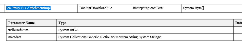

I did a trace to open a document saved in DocStar to see if there is an adapter method I could use and found this:
The issue I am having now is I cannot find an attchment adapter I could reference
