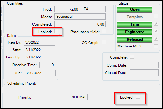

Of those jobs that show hours in the past any chance those jobs have either of the Locked boxes checked on them?

Yes, I have both set that way. I don’t see where that MRP check box is. Maybe I don’t have that module. My jobs are not locked in either field.
