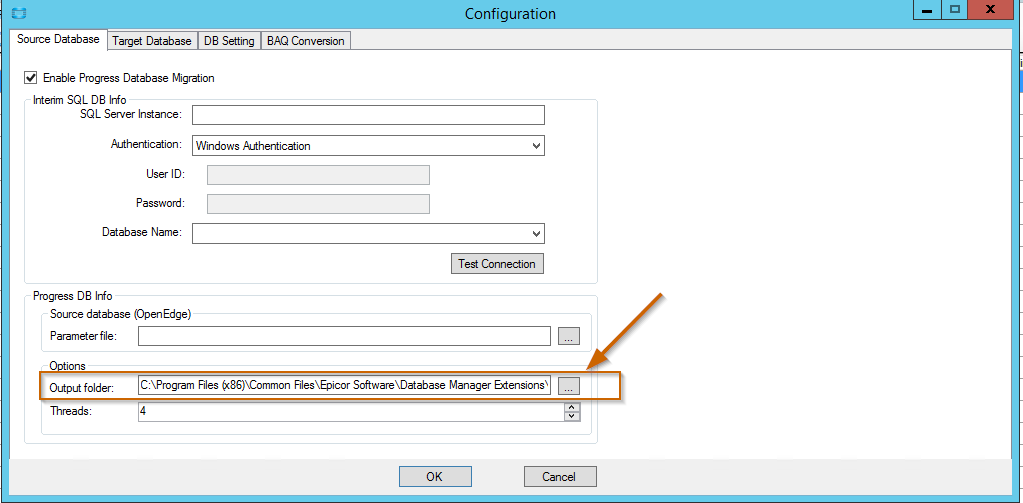

However, when I install the Epicor Administration Console (MMC) it looks like it defaults to C:\Program Files(x86)\common files\ . . . and that is where the intermediate migration database is built. That is not really taking full advantage of the FusionIO drive.

Regarding the above, if you change the Progress Output folder on the Configuration screen for the migration it will change where the interim database files are created as well - so you can change this location to a folder on your FusionIO drive.

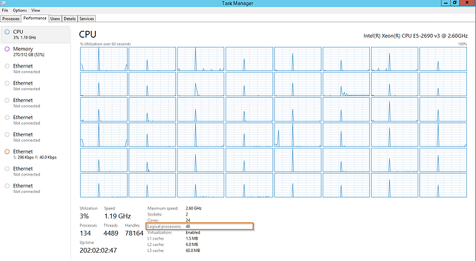

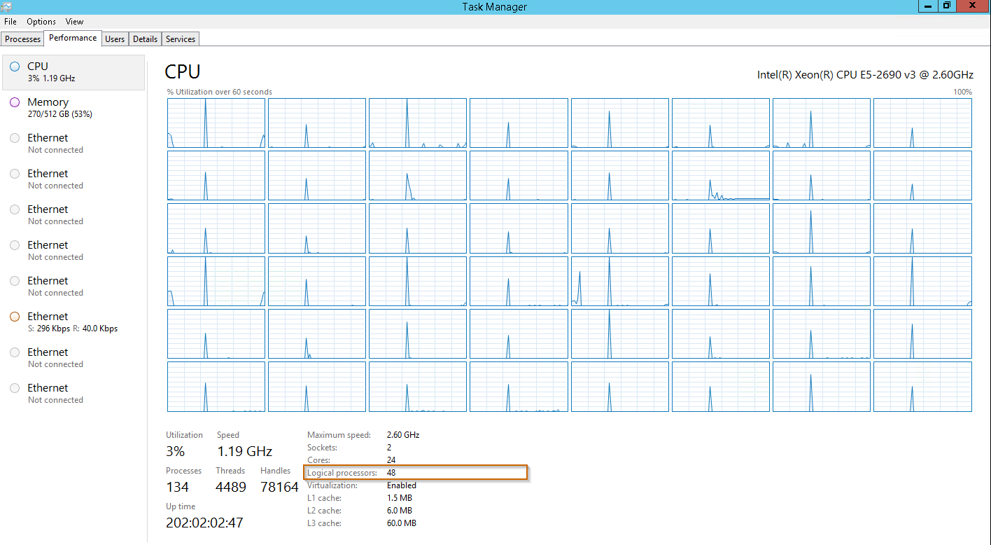

Additionally, my rule is that one should set two threads on this Configuration screen per logical CPU core that is on the migration machine. As the export of a single table is single threaded regardless of the number of threads specified, the more threads you have out there exporting those smaller tables the sooner the larger tables can start to be exported (if that makes sense). On my dedicated conversion machine, I specify 96 threads (logical processors X 2) when I complete a Progress migration to Epicor 10.1.
