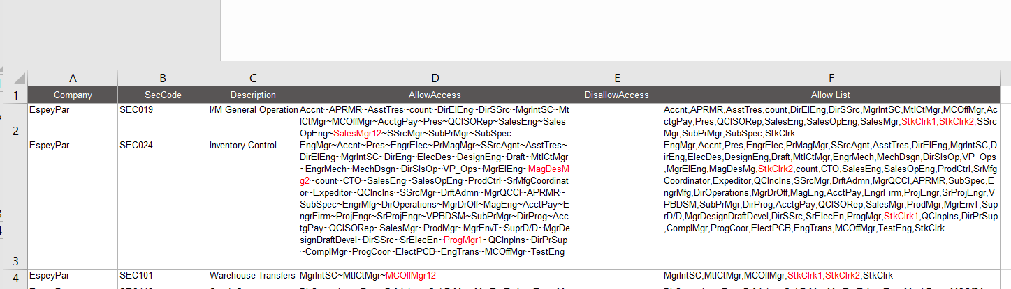

We have been using your BAQ for a while now with an update to the parameter to use Security Groups verses Users. It has been working great UNTIL recently. We are seeing something strange which we believe is in the NewEntryList calculated field during the replacement of the commas with tildes or possibly when adding the new security group.
We have two security group codes StkClrk1 and StkClrk2 which do not seem to be converting correctly. They are missing from the AllowAccess column and the numbers 1 & 2 seem to be appended to other security codes. Below is an example of what we are seeing. I added the Allow List column to see what the data looked like before going through the calculated NewEntryList field.
The StkClrk in the Allow List column is a new code we are just added and it is not showing in the AllowAccess assume because when I ran the BAQ I used CopyFrom StkClrk1 to StkClrk.
Hoping you can shed some light on what might be causing our issue.
