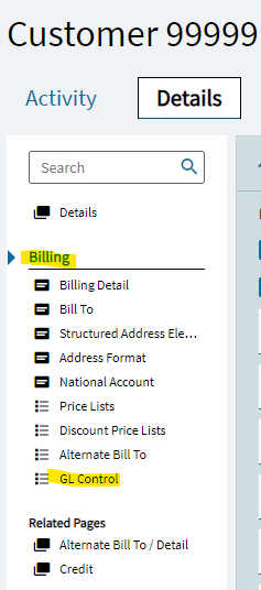

Thanks - we did think about doing this, but I haven’t found a customer GL setting. Does anyone know where to set Revenue and COGS GL on a Customer/SO level?
Try:
Customer > Billing > GL Control

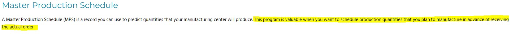

Master Production Schedule.
You are correct, an MPS will create the job (just like a Forecast will). Those two functionalities are more for planning multiple things that will happen in the future (like you want to build 1000 units over the course of a year and spread out the load). The OP indicated this is a one-off that happens now and again. It is no more work to create a single job than it is to create an MPS that will THEN create that single job via MRP.
