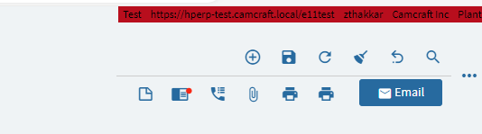

So, to add the toolbar icon:
  1. On a panel grid (or wherever), find the “Action Data” section. Sometimes it’s in “Advanced” sometimes not.
  2. Enter an ID and description.
  3. For the icon, enter “mdi” followed by the name of the mdi from the website. For example: “mdi mdi-note-outline”
  4. Check the “Add to Primary Toolbar”
  5. Save and test!
  • There’s no On-Click behavior *yet*, so you’ll have to wire up the event manually, using a trigger, hook, and referencing the control ID.

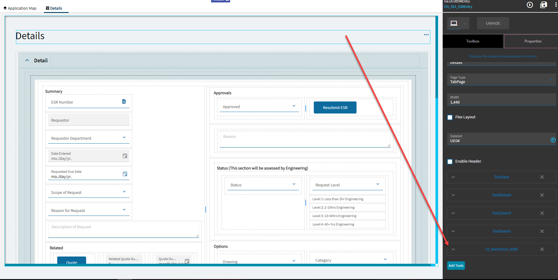

Alternate note, if you want it by the save tool, go to the Detail page, click the header, and add it from there.

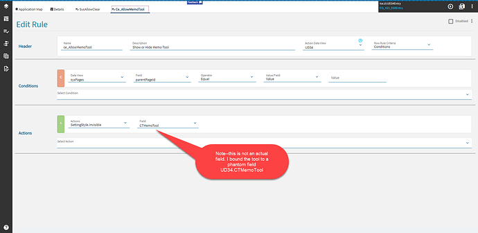

And then create a rule to hide it from the landing page (if you need).

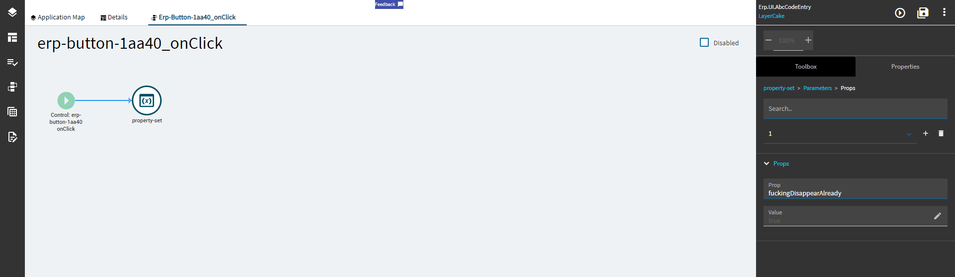

Is it possible to hide custom Tool using widget i.e. property-set? DataRules sometimes are not enough.
(Asking because for me it doesn’t work via property-set)
I can’t seem to get it to work.
Even THIS doesn’t work?! #SoSad
You have to keep searching for correct property name :stuck_out_tongue:
