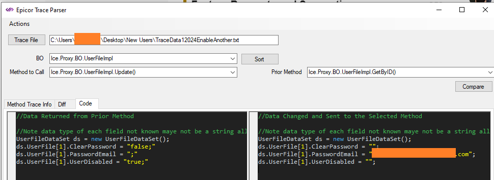

I’ve got something like this running in production as part of our offboarding process. I used UpdateExt to bypass some annoying errors. It required a service account with admin privileges to actually work, since admin rights are required to modify users.

This’ll do it.
try
    this.CallService<Ice.Contracts.UserFileSvcContract>(uf =>
        //Get the dataset
        var dsUserFile = uf.GetByID(UserID);
        //UnModified Record -> BeforeImage...
        var userFile = dsUserFile.UserFile.FirstOrDefault();
        //Get a new Record, this will be our updated Row
        Ice.Tablesets.UserFileRow updatedUserFileRow = (Ice.Tablesets.UserFileRow)dsUserFile.UserFile.NewRow();
        //Copy the unmodified row to the new row
        BufferCopy.Copy(userFile, updatedUserFileRow);
        //Modify the new row
        updatedUserFileRow.UserDisabled = !enable;
        updatedUserFileRow.RowMod = "U";
        //Add it to the dataset
        dsUserFile.UserFile.Add(updatedUserFileRow);
        //Update
        uf.Update(ref dsUserFile);
    Success = true;
catch (Exception ex)
    Success = false;
    ErrorMessage = ex.Message;
