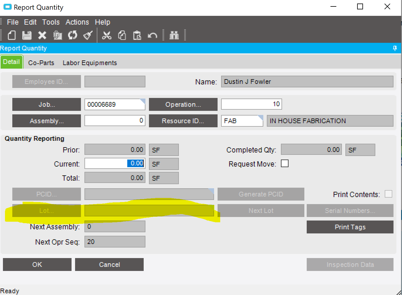

How to enable the Lot category in MES Report Qty
Can anyone tell me how to enable the following highlighted field? We would like to generate lots as we enter production through MES.
It is set on Part Maintenance through Track Lots on main Detail page.
Is the part that is being reported at that Operation marked as Lot Tracked?
Yes, but this would be for the last operation, not a subassembly.
When you are completing it and it is automatically being received to inventory.
The lot number can be set to default to the job number or you can setup a generate a unique number with a date stamp too.
Yes, currently during the MFG-INV transaction a Lot gets assigned through Job Receipt to Inventory. However, we wanted to add the lot on the first op when the material is made. Through other sources I have found out that I need to enable PCID to do so.
