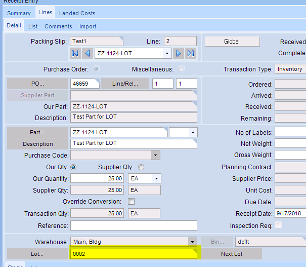

For purchased parts, you are required to enter the Lot number for the Qty that lot during PO receipt. Typically the Lot number (or code) is specified by the supplier.
You can use the “Lot…” button to search for an existing LOT to add to.
