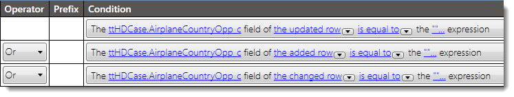

Within a data directive BPM, I have been trying to perform a very simple evaluation of an EpiUltraCombo control in the following manner:
This occurs at the end of a series of four additional and similar evaluations, all of which are against EpiTextBox controls.
The odd behavior that I’m experiencing is…
If there is NO value in the combo-box control, the BPM logic works just fine. However, if a value is present in the combo-box control, none of the other textbox evaluations occur.
To be more precise, if no values exist for the five controls, all logic works. If values exist for all textbox controls, but not for the combo-box, all logic works. If I remove all values from the five controls, then place one value in any of the textboxes and a value in the combo-box, none of the BPM logic works.
I have also tried evaluating for null instead of a blank string in the combo-box, but that did not seem to work either.
