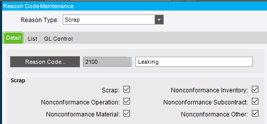

Reason Codes
More than just information, they can be tied to GL controls, to determine what accounts to hit.
WARNING: On the subject of accounting: deleting a DMR rejection reverses the transaction quantity properly, but it will probably hit the wrong accounts because it looks a level higher in the hierarchy. If someone remembers the details of that, please comment.
Nonconformance reason codes are of type Scrap. Let that sink in.
Check the appropriate boxes.
