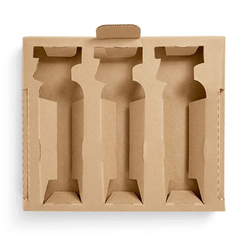

Ah, I was thinking it was die-cut foam.

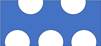

I was thinking it could be this:
The foam would be cut like:
