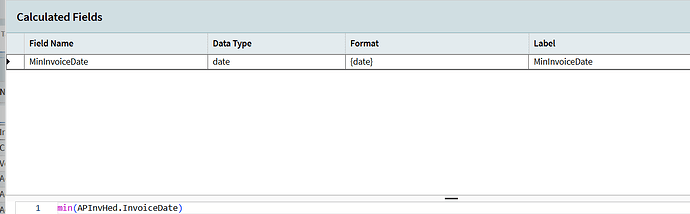

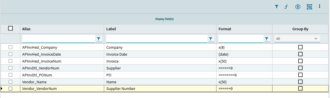

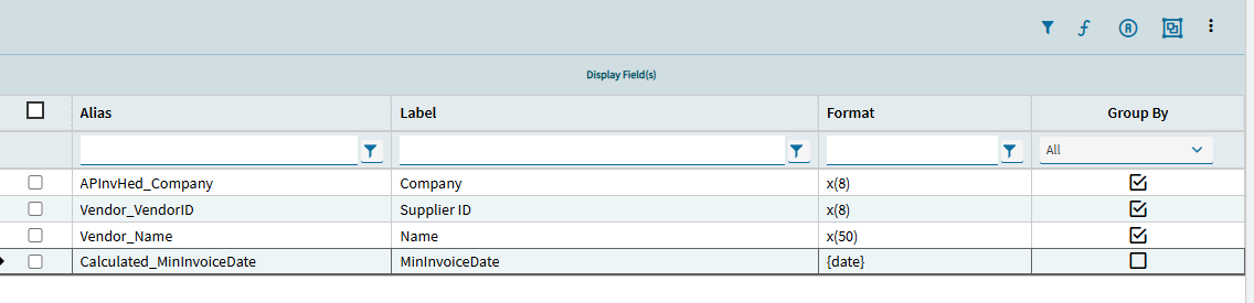

So far I have gotten here , is this the correct guideline?

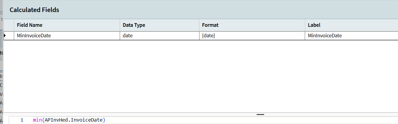

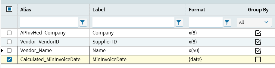

You’re on the right track. Just take fields Company, VendorID and Name. Group them and also grab the Min value on InvoiceDate and that should work.
Got it followed same format

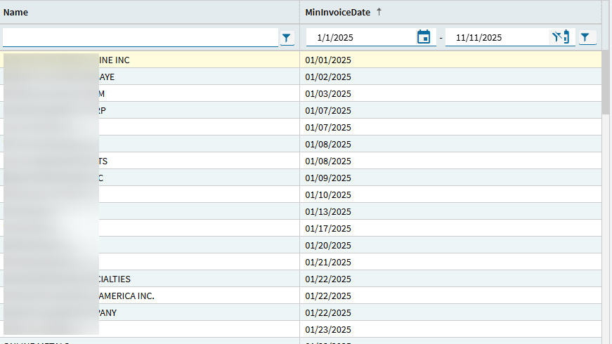

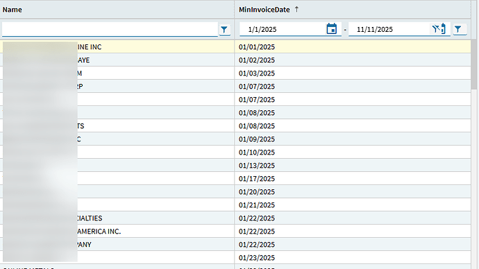

Results :
And just to understand , so exactly how I have it filtered from 1-1-25 to 11-11-25 , these are the Suppliers we have added from that time frame. As the data is calculated on the minimum ( 1st) invoice date of that Supplier?
Yes, that would be the first invoice date for the vendor in question. The vendor record may have been CREATED in Kinetic prior to that date…but seeing that the create date is not tracked in base, and if you don’t have a change log set up for the Vendor table, this is likely as good a guesstimate as you’re going to get.
