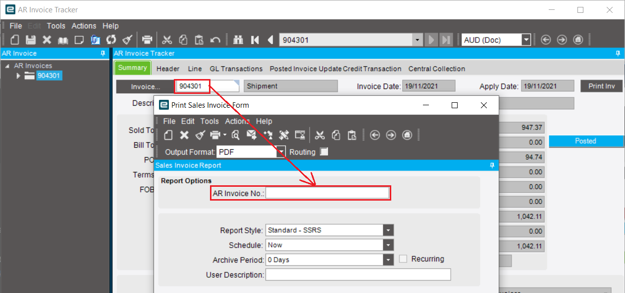

Hello everyone,
We have added a Print button in AR Invoice Tracker and it’s calling the BAQ Report Designer “Print Sales Invoice Form”. How can I get the Invoice No. entered in AR Invoice Tracker and pass it to the BAQ Report Designer so it will automatically fill out the AR Invoice No. field?

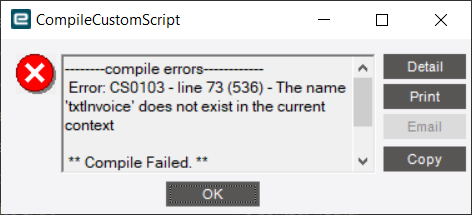

Hi @syed2ibrahim thanks for your response. I tried it and it seems that the code for “lfo.ValueIn = (txtInvoice.Text);” is not working. I’m getting this error:
It seems that I’m missing something and I cannot figure it out. Please help. Thanks.

Try to get invoice value from view not textfield as your field is binded field.
syed2ibrahim
(syed ibrahim mohamed jalaludeen)
February 2, 2022, 6:10am
#5
Hi @daisygonzales ,
EpiDataView edvInvcHead = ((EpiDataView)(this.oTrans.EpiDataViews[“InvcHead”]));
int txtInvoice = Convert.ToInt32(edvInvcHead .dataView[edvInvcHead .Row][“InvoiceNum”]);
or
EpiTextBox txtInvoice = (EpiTextBox)csm.GetNativeControlReference(“22bd4d9e-f149-4794-847a-17e04ecdeeba”);
Add the above code into your invoice button click event.
