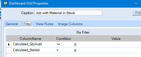

@Epicorus I never really got a handle on Epicor’s availability calculation, It was too optimistic for us. We recently had this need to know what jobs can I put on the floor today and I built a dashboard for operations. Attached is a generic version of it. The time phase part was from a post here already. MatStockEpicHelp.dbd (177.2 KB)
I found instructions on anther thread about making the baq file into a zip unzipping and editing the BAQVersion and the rezipping. I did that and then imported this into my 10.2.400 and exported it again.
I’m not sure how to interpret the QtyAvail field - for some jobs it is empty, for others it is a much larger number than the ProdQty, and for some it is insanely negative (the smallest number I saw was -4,354).
