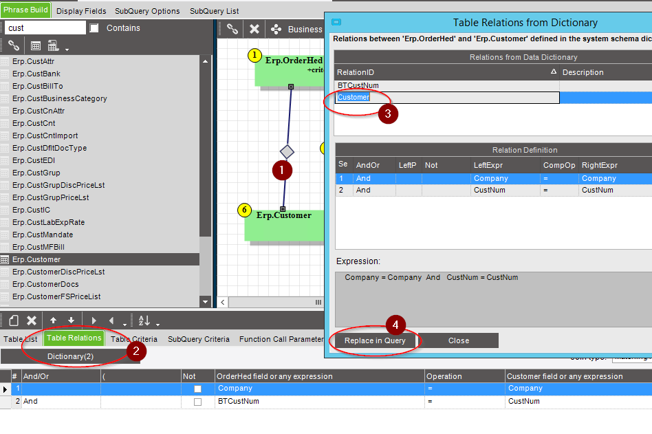

One helpful thing in BAQs that people don’t always know… when you join the OrderHed to the Customer table, there is a little “Dictionary(2)” button… this is telling you that there are two possible dictionary join options pre-defined. You can choose which one to use… here is the view when linking OrderHed to Customer:

This little feature is useful as well. I will keep my eye out for it from now on. Sincere thanks.
