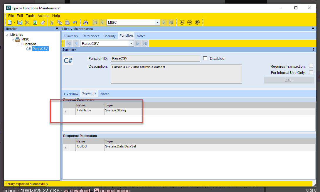

I made progress. Once I put a message in the catch I found my issue. I followed the instructions above and when I try to save/compile my function I am getting an error stating that there is no argument that corresponds to the required parameter FileName. I tried to follow the instructions but am stuck on this at the moment.
Do you have this?
Yes. If I delete it, this error will go away but I have to have it in order to get my file to come across. I can send you a screen shot but it looks exactly like this.
Are you calling that function from another function and forgetting to pass the FileName param?
No. I am doing it from, app studio.
You can’t compile a function in App Studio, so there’s a disconnect here.
If you’re receiving that parameter error in Function Entry (only exists in Classic), that tells me you’re trying to call this function from a different function and forgetting to include the parameter in the signature.
If you’re receiving that error in App Studio, that tells me you didn’t define the parameter value in Method Parameters of the function widget OR you did and it’s undefined. If it’s undefined, you’ll need to use Dev Tools to look at the data you’re passing and go from there.

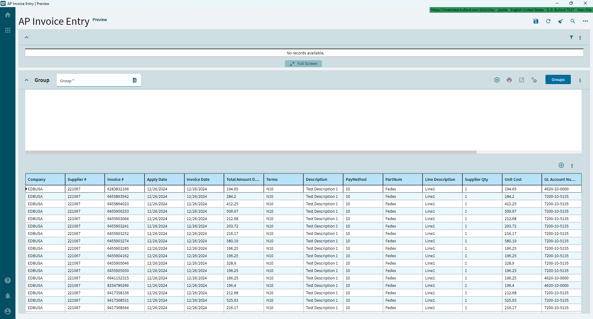

Hey Guys, I followed Hannah’s article and finally got the csv file data on my grid. I followed the instructions and created a new grid and such. What I need though is this data to go to an existing grid on the AP invoice Entry screen. How can I route my csv file data to that grid? Change the EPI Binding somewhere?
Change the View Name in the function widget’s response params.
Cool. I will try that.
