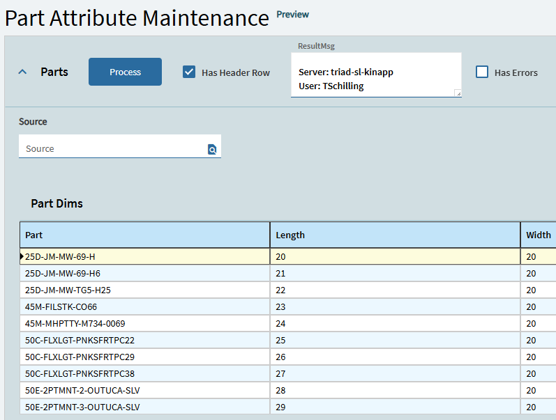

How To: Kinetic - Upload a Client File, Parse, and Display in a Grid
I did that but the data didn’t come though correctly. Does the grid I am moving to have formatting that would cause this? I got the same number of records but some of the columns just had 0.00 in them and most of them were blank.
Let’s see the json for your data vs the original data.
Or the dataview columns vs your data.

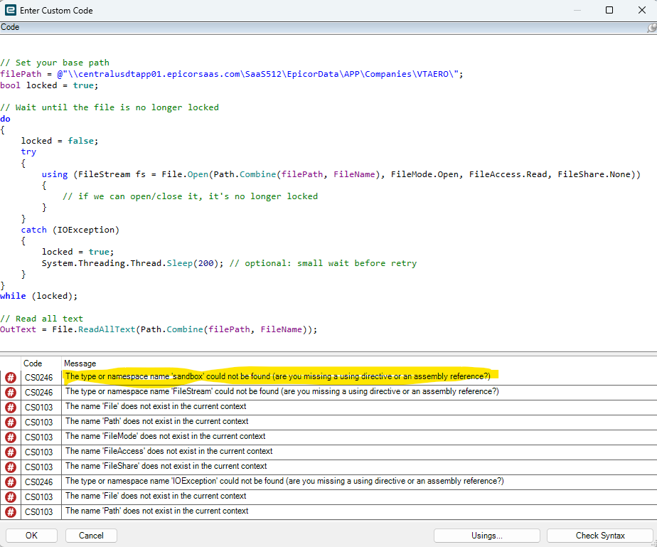

I thought I could use this approach, but I can’t even get my function to compile. I converted Hannah’s code to the code below with the help of GPT:
using System.IO;
// Set your base path
string filePath = @"\\SERVER\EpicorData\APP\Companies\Company\Uploads\";
bool locked = true;
// Wait until the file is no longer locked
do
    locked = false;
    try
        using (FileStream fs = File.Open(Path.Combine(filePath, FileName), FileMode.Open, FileAccess.Read, FileShare.None))
            // if we can open/close it, it's no longer locked
    catch (IOException)
        locked = true;
        System.Threading.Thread.Sleep(200); // optional: small wait before retry
while (locked);
// Read all text
OutText = File.ReadAllText(Path.Combine(filePath, FileName));
Syntax check is ok, but when I try to save the function I get the errors:
AddFile.cs(63,32): warning ECF1002: The ‘System.IO.File.Open(string, System.IO.FileMode, System.IO.FileAccess, System.IO.FileShare)’ method cannot be called.
AddFile.cs(77,11): warning ECF1002: The ‘System.IO.File.ReadAllText(string)’ method cannot be called.
Do I need to add some references to my function library?

I think they changed to using Sandbox.IO or something like that for “security” reasons.
Well, not only security. In General programming, we’ve ALWAYS been warned about adding full path references to our code. The code is more portable if we use relative references. If your Epicor server moves during an upgrade, now all of these file references break. With the advent of containers, we can’t guarantee the name of our servers anymore. We name our pets, but shouldn’t do the same for cattle.
On the security front, do we want application programmers gaining access to any directory on our server? This code is running as a different account and it may have more privileges than the user.
I’m one of the few “old guys” who doesn’t complain about Sandbox.IO. It directs coders to use better programming practices, IMHO.

basically anytime you use system.io, instead use sandbox.io equivalent.
The only reference I have to System.IO is in the Usings. It’s not in my code at all. When I replace System.IO with Sandbox.IO (or sandbox.IO), I get compile errors and can’t continue.
I did start down that dumpster fire of a thread but didn’t see how to actually use this fancy sandbox. I looked over the examples on github, and they look like they just replaced system with sandbox.
Do I need to include some extra reference to allow Sandbox in my function?
I’m no function wizard but yes replace the reference to system.io with sandbox.io. I may’ve read the sandbox reference is not needed so you could try just removing the system.io ref first. I believe there are slight diffs in some of the sandbox equivalents so you may still have a few compile errors but should narrow to just what’s different so you can take it from there.
In a pinch, you could add Sandbox.IO to all of your file methods.
FileStream fs = Sandbox.IO.File.Open(...
OutText = Sandbox.IO.File.ReadAllText(...
etc.

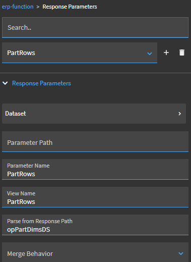

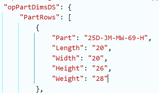

Following the instructions to the letter but data is not loading on to the grid.
Response parameter for the dataset is fine. Function is returning response parms correctly.
Setting up the response parm exactly as shown in the example using my names.

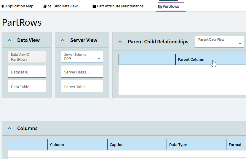

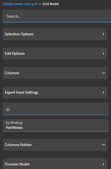

Doesn’t look like all my snippets made it.
Grid binding.
Data view.
