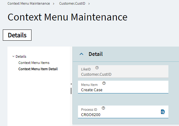

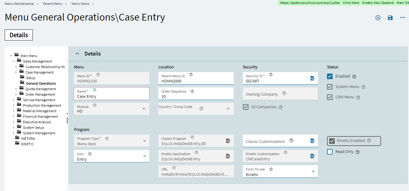

The system does it internally via context menus, in particular:
But in my case I have a “helpdesk customer tracker” type view (based on Customer Entry) and when they have opened a customer up i want them to be able to create a case for that customer with a button.
I thought I’d peek inside CRGO6200 above to see how its done, but can’t see this menu item listed anywhere else than its context menu reference.

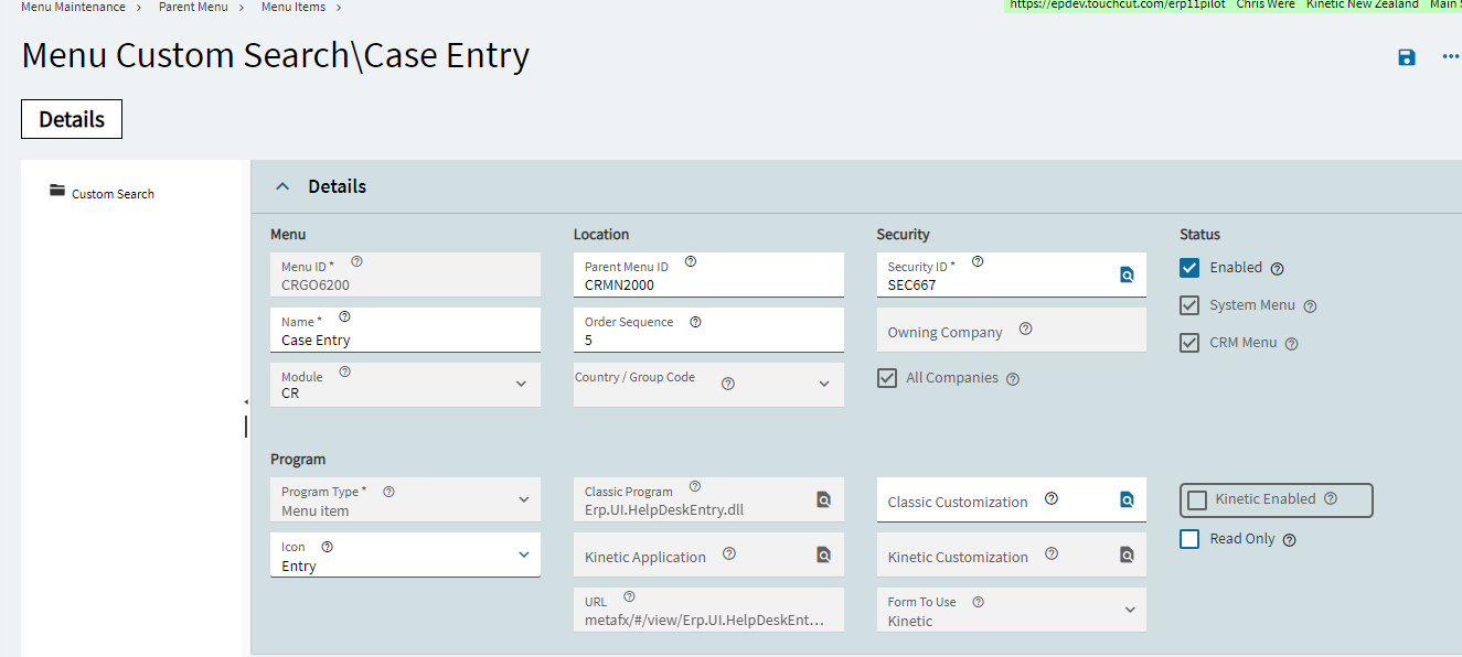

It’ll be listed under the processes at the bottom of menu maintenance.
If you’d like you can either call it via processcaller, or copy the item to a regular menu item to explore.
Ah, found it, searched under “All” for “case”
so its just calling the regular HelpDeskEntry application

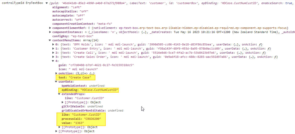

Hi Kevin, I haven’t been able to find launch options for the standard Case entry application, but inspecting the controls in dev tools, and looking at text box bound to custID on a form I can see its context menu items, and what they trigger (first time I’ve managed to find something useful and not get overwhelmed by the sheer volume of data in dev tools, pretty cool!):

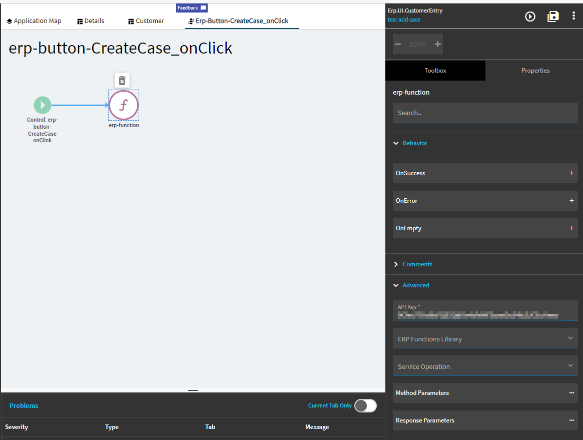

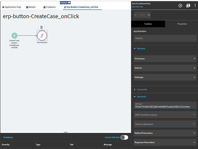

I have an API key (created in API Key maintenance) which we are using successfully with an external time tracking application to make REST calls.
I put this in my erp-function, but I see no ERP Functions Libraries listed.
I can’t see how to get to ProcessCaller, and much googling hasn’t helped. I’m missing something fundamental…

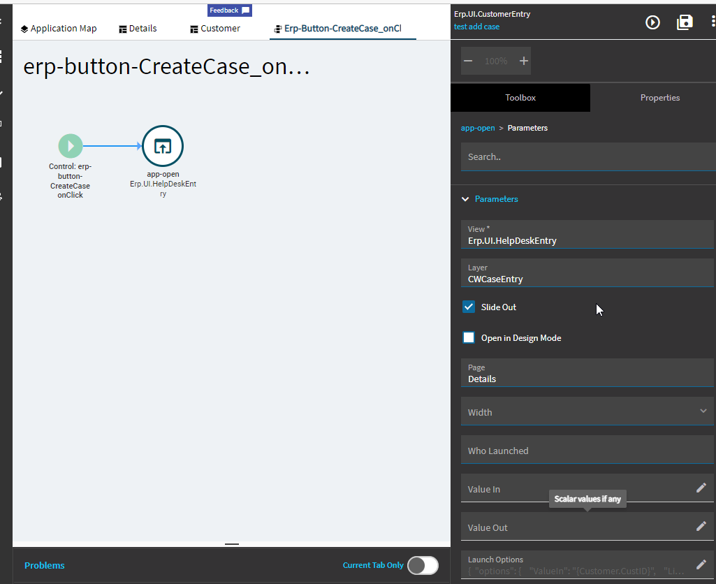

Hang on, there’s an app-open thingummy in the toolbox…

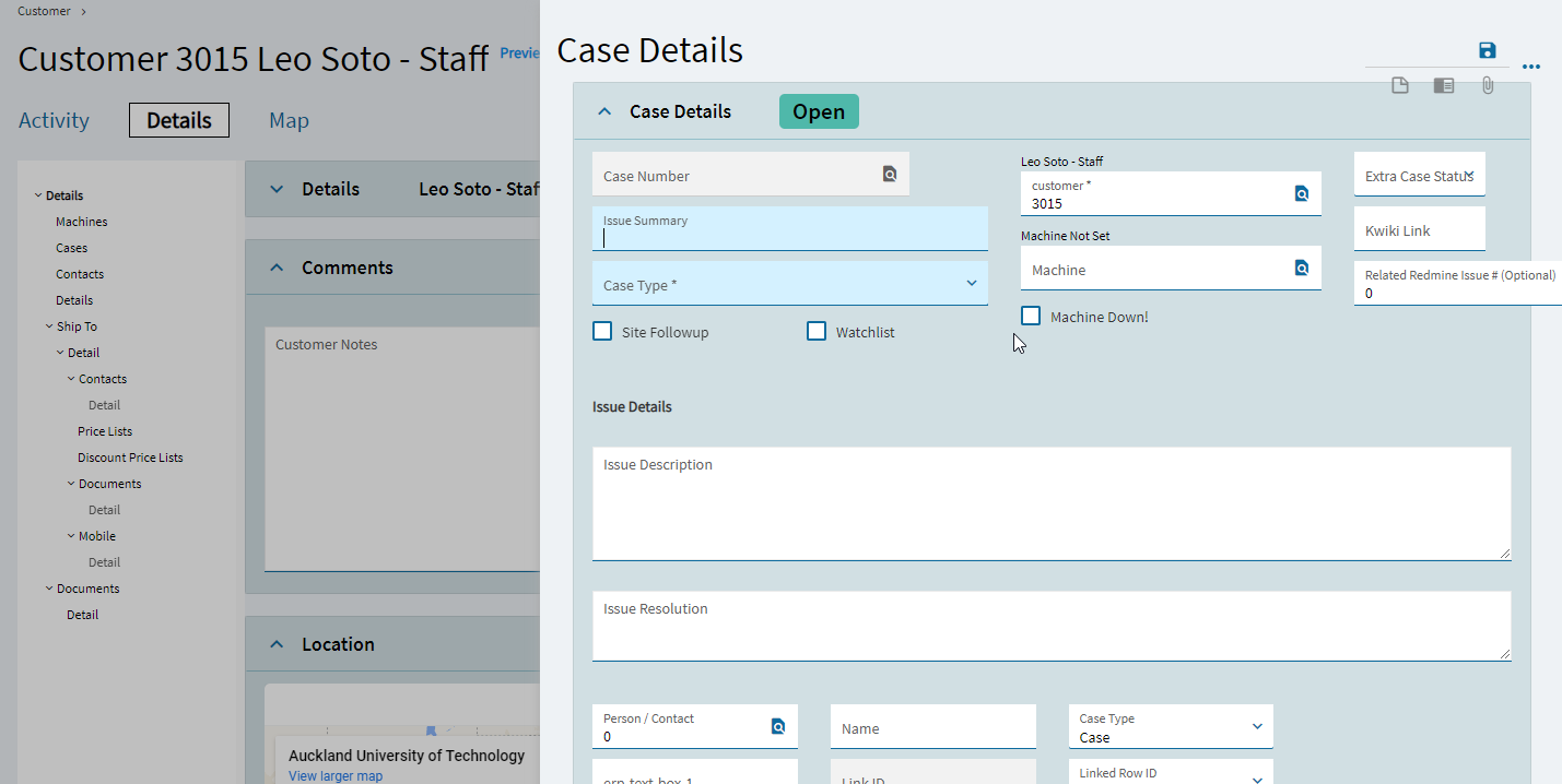

Success. It even pops it in a slide out which looks nice; end users may disagree…:
Here’s the run through, start with the button triggering app-open:

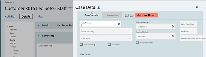

With no Launch options, I don’t get a new case, just a blank form waiting for me to enter an existing case number:
However adding this to Launch Options:
	"options": {
		"ValueIn": "{Customer.CustID}",
		"Like": "Customer.CustID"
makes the magic happen:
Thanks also to @hmwillett for this piece of awesomeness, including the epDebug.context nugget:
After using this I got:
I basically threw all that into the Launch Options with very little expectation of success and was amazed when it worked. Peeled back until had just the valueIn and Like fields.
