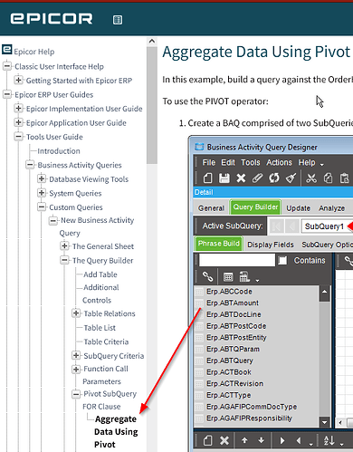

You can do a pivot in the BAQ. It just has to be specific criteria, but since you are doing months, that would work. Pivots are kind of a pain to work with, but work fine once you get them. Check out the tools user guide and give it a shot, if you get stuck, let us know what issues you are having.

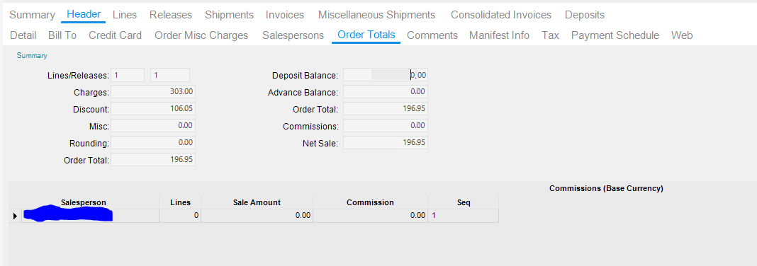

Thanks for your reply! I think it is getting me somewhere. Now, I’m trying to figure out how to handle the actual totals, and match them up to our Rep. We have the OrderHed table, which includes my salespersons for the order.
According to my table, each of those have their own field (ex SalesRepCode1, SalesRepCode2, etc.). When we come over to order totals, what we want is the ‘OrderHed.DocOrderAmt’ or ‘Order Total:’
This is simple for a single rep, but I’m not quite sure how to handle a split order. If it is an 80% 20% split for commission…we should calculate that against the order total, and give each rep that amount for the month of the order.

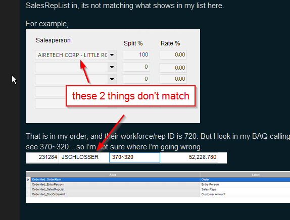

@Banderson And it’s sort of confusing too…because when I look in my order tracker…I see fields aligning with OrderHed.SalesRepCode1, but when I look in my BAQ I only see SalesRepList. However, if i put SalesRepList in, its not matching what shows in my list here.
For example,
That is in my order, and their workforce/rep ID is 720. But I look in my BAQ calling out SalesRepList and I see 370~320…so I’m not sure where I’m going wrong.

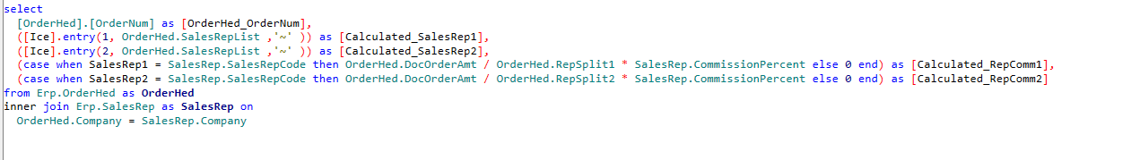

My approach (may be other solutions)… break the SalesRepList into individual calculated fields… below is an example:
CalcField: SalesRep1 (nvarchar)
CalcField Expression: [Ice].entry(1, OrderHed.SalesRepList ,‘~’ )
CalcField: SalesRep2 (nvarchar)
CalcField Expression: [Ice].entry(2, OrderHed.SalesRepList ,‘~’ )
So this is splitting your OrderHed.SalesRepList… anywhere it sees a tilde (~). Entry 1 is your SalesRep1, Entry 2 is your SalesRep2, etc.
Then you can do other calculations based on your commission structure. Below is an example, but tweak as required:
Calc Field: Rep1Comm (Int)
Expression:
(case when SalesRep1 = SalesRep.SalesRepCode then OrderHed.DocOrderAmt / OrderHed.RepSplit1 * SalesRep.CommissionPercent else 0 end)
Calc Field: Rep2Comm (Int)
Expression:
(case when SalesRep2 = SalesRep.SalesRepCode then OrderHed.DocOrderAmt / OrderHed.RepSplit2 * SalesRep.CommissionPercent else 0 end)

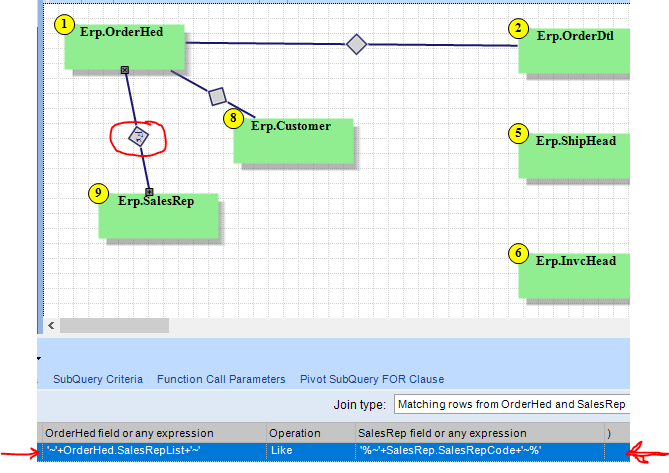

I’m a little confused about how to get it working. I don’t really see any connection between OrderHed and SalesRep that I can use in a BAQ.
I don’t know what you’re looking at here, but the orders that you are looking at are not the same. If that record had 2 you should see two in the drop downs. Something is funky with what you are doing.
Remember, you have header, and line salesmen records
I’m going to look more into every field in the orderhed table, but Entry Person is our internal person that entered the order, not the rep…but apparently you were right anyways…somehow I was looking at the wrong order.
Oops… forgot that piece. You can join SalesRep table to OrderHed with the below Relationship:
So my query join looks like this:
Ok so @dcamlin after I have them linked…it separates out to two different records, one for each rep. How do I take it a step further to know which rep split goes with which rep. Theoretically in the end I’d like one row that says “Total” and it doesn’t matter which RepSplit number it was…
