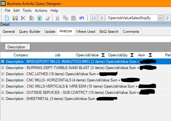

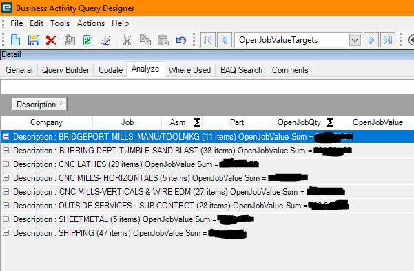

Good morning,
I have these two BAQs that when grouped and summarized, gives me the nice compact data I want:
1
2
I would like to know if there is a way to combine this data at the BAQ report level. I want to output a BAQ report that shows these summaries by department, on the same line. I want to see the value from both BAQs for each department. (i.e. SHEETMETAL $10000, $150000)
But I also want to retain the details so that we can see the job level information for each department. In these BAQs. The department summaries contain all of the individual job values. I don’t want to lose this by grouping the BAQ before the output.
How can I get each department’s summary value to appear on the same line in the report? For example at the top of the report I just want an overview of all the departments and the two values from the two BAQs. Later in the report I want to see the details for each department showing the individual job details.
Department	Target	Value
BRIDGEPORT MILLS, MANU/TOOLMKG (11 items) 	0.815006201	0.257809802
BURRING DEPT-TUMBLE-SAND BLAST (38 items) 	0.626771116	0.562242369
CNC LATHES (29 items) 	0.747821818	0.118868699
CNC MILLS- HORIZONTALS (5 items) 	0.346049237	0.967649284
CNC MILLS-VERTICALS & WIRE EDM (27 items) 	0.406049747	0.183155667
OUTSIDE SERVICES - SUB CONTRCT (28 items) 	0.153759217	0.076246399
SHEETMETAL (5 items) 	0.438929624	0.468706028
SHIPPING (47 items) 	0.793828876	0.317907666
Summaries for BURRING DEPT-TUMBLE-SAND BLAST
Company	Job	OpenJobValue	OpenJobTarget	OpenJobQty	Asm	Part	NextOp	Req. By	Start	Due Date	Date08	Status
VTAERO	0.411170598	0.881702973	0.72536385	0.798061844	0	0.738204863	100	12/19/2022	3/22/2023	3/24/2023	3/24/2023	Late
VTAERO	0.982028102	0.535926313	0.517035586	0.040715577	0	0.559562819	160	3/1/2023	3/21/2023	4/12/2023	3/31/2023	Late
VTAERO	0.329288593	0.630012925	0.78852581	0.170548699	0	0.704225714	20	5/10/2023	5/1/2023	5/10/2023	3/31/2023	On Time

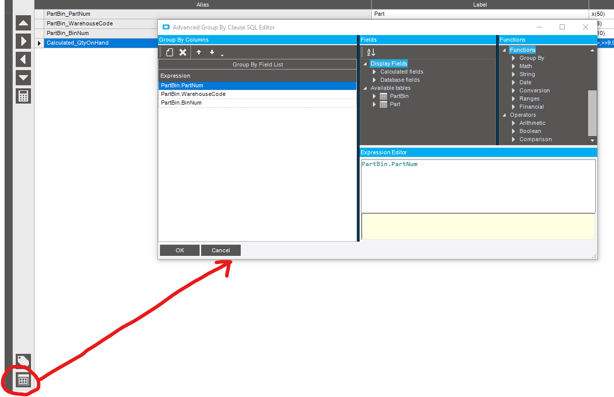

If you’re in for a ride, check out the documentation on Advanced Group By. @LarsonSolutions presented on this at our last EUG meeting. It was pretty cool. You get the best of both worlds. I don’t know it well enough to teach it but if you look around maybe there are some posts on here. I’ll reach out and see if I can get the notes from that EUG meeting. If I can, I’ll share.

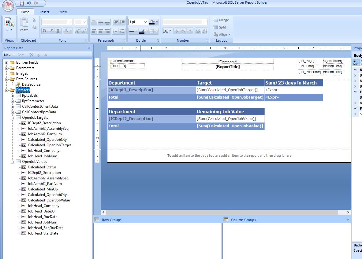

I have the two BAQs in the RDD without joins. and I can pull in the values into the report. It is spitting out the right data. Now I just need to figure out that next step of:
Can you say how to do this? I am not very good with CTEs. Do I setup a third Dataset that joins the two existing datasets?
My two datasets have these expressions:
OpenJobValues:
="SELECT  T1.[Calculated_Status], T1.[JCDept2_Description], T1.[JobAsmbl2_AssemblySeq], T1.[JobAsmbl2_PartNum], T1.[Calculated_MinOp], T1.[Calculated_OpenJobQty], T1.[Calculated_OpenJobValue], T1.[JobHead_Company], T1.[JobHead_Date08], T1.[JobHead_DueDate], T1.[JobHead_JobNum], T1.[JobHead_ReqDueDate], T1.[JobHead_StartDate]
 FROM
OpenJobValues_" + Parameters!TableGuid.Value + " T1"
OpenJobTargets:
="SELECT  T1.[JCDept2_Description], T1.[JobAsmbl2_AssemblySeq], T1.[JobAsmbl2_PartNum], T1.[Calculated_OpenJobQty], T1.[Calculated_OpenJobTarget], T1.[JobHead_Company], T1.[JobHead_JobNum]
 FROM
OpenJobTargets_" + Parameters!TableGuid.Value + " T1"
Sure thing. Give me a few minutes.
Here you go. I would just choose one of the datasets (does not matter which one) and edit the query definition. I did not remove any duplicate fields or define the join fields as I was not sure what it would be, but you can edit as needed. Just make sure to have that ; in the beginning, it won’t work without it.
=";WITH CTE (Calculated_Status, JCDept2_Description, JobAsmbl2_AssemblySeq, JobAsmbl2_PartNum, Calculated_MinOp, Calculated_OpenJobQty, Calculated_OpenJobValue, JobHead_Company, JobHead_Date08, JobHead_DueDate, JobHead_JobNum, JobHead_ReqDueDate, JobHead_StartDate, JCDept2_Description, JobAsmbl2_AssemblySeq, JobAsmbl2_PartNum, Calculated_OpenJobQty, Calculated_OpenJobTarget, JobHead_Company, JobHead_JobNum)
AS
	SELECT  T1.[Calculated_Status], T1.[JCDept2_Description], T1.[JobAsmbl2_AssemblySeq], T1.[JobAsmbl2_PartNum], T1.[Calculated_MinOp], T1.[Calculated_OpenJobQty], T1.[Calculated_OpenJobValue], T1.[JobHead_Company], T1.[JobHead_Date08], T1.[JobHead_DueDate], T1.[JobHead_JobNum], T1.[JobHead_ReqDueDate], T1.[JobHead_StartDate], T2.[JCDept2_Description], T2.[JobAsmbl2_AssemblySeq], T2.[JobAsmbl2_PartNum], T2.[Calculated_OpenJobQty], T2.[Calculated_OpenJobTarget], T2.[JobHead_Company], T2.[JobHead_JobNum]
 FROM
OUTER JOIN OpenJobTargets_" + Parameters!TableGuid.Value + " T2
ON T1 = T2
SELECT Calculated_Status, JCDept2_Description, JobAsmbl2_AssemblySeq, JobAsmbl2_PartNum, Calculated_MinOp, Calculated_OpenJobQty, Calculated_OpenJobValue, JobHead_Company, JobHead_Date08, JobHead_DueDate, JobHead_JobNum, JobHead_ReqDueDate, JobHead_StartDate, JCDept2_Description, JobAsmbl2_AssemblySeq, JobAsmbl2_PartNum, Calculated_OpenJobQty, Calculated_OpenJobTarget, JobHead_Company, JobHead_JobNum
FROM CTE"
Hmmm seems there is a syntax error in there near T1. This sure is strange syntax! I replaced the query text in the dataset for the OpenJobValues. I also added the field OpenJobTarget to the Dataset field list as a query field.

I removed the ā€œduplicateā€ fields referenced in the first CTE, and in the last SELECT statements. Now that there are a unique list of fields, I get a new error about the number of fields not matching. I am pretty sure they match!
=";WITH CTE (Calculated_Status, Calculated_MinOp, Calculated_OpenJobValue, JobHead_Date08, JobHead_DueDate, JobHead_JobNum, JobHead_ReqDueDate, JobHead_StartDate, JCDept2_Description, JobAsmbl2_AssemblySeq, JobAsmbl2_PartNum, Calculated_OpenJobQty, Calculated_OpenJobTarget, JobHead_Company, JobHead_JobNum) AS (SELECT  T1.[Calculated_Status], T1.[JCDept2_Description], T1.[JobAsmbl2_AssemblySeq], T1.[JobAsmbl2_PartNum], T1.[Calculated_MinOp], T1.[Calculated_OpenJobQty], T1.[Calculated_OpenJobValue], T1.[JobHead_Company], T1.[JobHead_Date08], T1.[JobHead_DueDate], T1.[JobHead_JobNum], T1.[JobHead_ReqDueDate], T1.[JobHead_StartDate], T2.[JCDept2_Description], T2.[JobAsmbl2_AssemblySeq], T2.[JobAsmbl2_PartNum], T2.[Calculated_OpenJobQty], T2.[Calculated_OpenJobTarget], T2.[JobHead_Company], T2.[JobHead_JobNum] FROM OpenJobValues_" + Parameters!TableGuid.Value + " AS T1 FULL OUTER JOIN OpenJobTargets_" + Parameters!TableGuid.Value + " AS T2 ON T1.[JobHead_Company] = T2.[JobHead_Company] AND T1.[JCDept2_Description] = T2.[JCDept2_Description] AND T1.[JobHead_JobNum] = T2.[JobHead_JobNum]) SELECT Calculated_Status, Calculated_MinOp, Calculated_OpenJobValue, JobHead_Date08, JobHead_DueDate, JobHead_JobNum, JobHead_ReqDueDate, JobHead_StartDate, JCDept2_Description, JobAsmbl2_AssemblySeq, JobAsmbl2_PartNum, Calculated_OpenJobQty, Calculated_OpenJobTarget, JobHead_Company, JobHead_JobNum FROM CTE"

I made all the fields unique
=";WITH CTE (OJV_Calculated_Status, OJV_JCDept2_Description, OJV_JobAsmbl2_AssemblySeq, OJV_JobAsmbl2_PartNum, OJV_Calculated_MinOp, OJV_Calculated_OpenJobQty, OJV_Calculated_OpenJobValue, OJV_JobHead_Company, OJV_JobHead_Date08, OJV_JobHead_DueDate, OJV_JobHead_JobNum, OJV_JobHead_ReqDueDate, OJV_JobHead_StartDate, OJT_JCDept2_Description, OJT_JobAsmbl2_AssemblySeq, OJT_JobAsmbl2_PartNum, OJT_Calculated_OpenJobQty, OJT_Calculated_OpenJobTarget, OJT_JobHead_Company, OJT_JobHead_JobNum)
SELECT OJV_Calculated_Status, OJV_JCDept2_Description, OJV_JobAsmbl2_AssemblySeq, OJV_JobAsmbl2_PartNum, OJV_Calculated_MinOp, OJV_Calculated_OpenJobQty, OJV_Calculated_OpenJobValue, OJV_JobHead_Company, OJV_JobHead_Date08, OJV_JobHead_DueDate, OJV_JobHead_JobNum, OJV_JobHead_ReqDueDate, OJV_JobHead_StartDate, OJT_JCDept2_Description, OJT_JobAsmbl2_AssemblySeq, OJT_JobAsmbl2_PartNum, OJT_Calculated_OpenJobQty, OJT_Calculated_OpenJobTarget, OJT_JobHead_Company, OJT_JobHead_JobNum FROM CTE"
I will post a seperate thread with attachments
I don’t understand how you made each field unique. I see that you added OJV, and OJT to the beginning of the field name, but shouldn’t you have to define those tables using the same prefix? The fields don’t have those prefixes on them, so there is no way for the SQL to know which fields you are asking for. Right?
This code does not produce errors, but returns a blank report with no data.
@NateS , I was thinking about this this morning and I definitely over thought the solution. You should not have to do the CTE and should be able to get away with just combining them in the query definition.
="SELECT  T1.[Calculated_Status], T1.[JCDept2_Description], T1.[JobAsmbl2_AssemblySeq], T1.[JobAsmbl2_PartNum], T1.[Calculated_MinOp], T1.[Calculated_OpenJobQty], T1.[Calculated_OpenJobValue], T1.[JobHead_Company], T1.[JobHead_Date08], T1.[JobHead_DueDate], T1.[JobHead_JobNum], T1.[JobHead_ReqDueDate], T1.[JobHead_StartDate], T2.[JCDept2_Description], T2.[JobAsmbl2_AssemblySeq], T2.[JobAsmbl2_PartNum], T2.[Calculated_OpenJobQty], T2.[Calculated_OpenJobTarget], T2.[JobHead_Company], T2.[JobHead_JobNum]
ON T1.[JobHead_Company] = T2.[JobHead_Company] AND T1.[JCDept2_Description] = T2.[JCDept2_Description] AND T1.[JobHead_JobNum] = T2.[JobHead_JobNum]"
That should work just fine. I was thinking that combining the two BAQs together in one BAQ would work, which is where I thought of doing the CTE. Then I carried the thought of doing the CTE over to the SSRS report, which was not needed.
