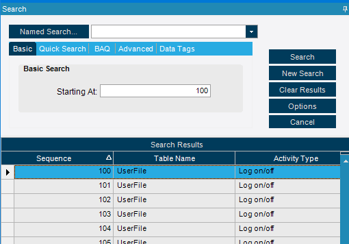

When I open the search box in System Activity Purge, there is no option to enter a cut-off date. Unfortunately, in 10 months, this table has grown to 30GB and 90M rows! I bet “return all records” would crash Epicor, or put a serious hurt on the DB.
I tried entering a date in the ‘Starting At’ searchbox - It wouldn’t take a forward slash, so I entered the date as 02162019 for Feb 16, 2019, but the search returned results after that date.

The “Starting at” filed is the Sequence Number (i.e. record number). I just kept increasing the number by 10X, until I got no results. My last number is 47,602 (well under your 90,000,000).
They appear to be ordered oldest (lowest Seq #) to newest (highest Seq #). And setting your search to return more than 10,000 records will return them in the search window. But only the first 10,000 are returned to the form (even when I click “Select 1-30,000”)

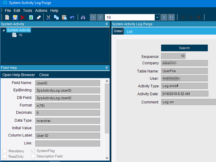

Might be a bit off topic, but what is the Ice.SysActivityLog table used for? We’ve been running Epicor for over 5 years and my last number is 48. The only entries I see are related to “Log on failure” if someone tried to enter a bad password (we use single sign on so this would only happen if someone tried to use the wrong app server).

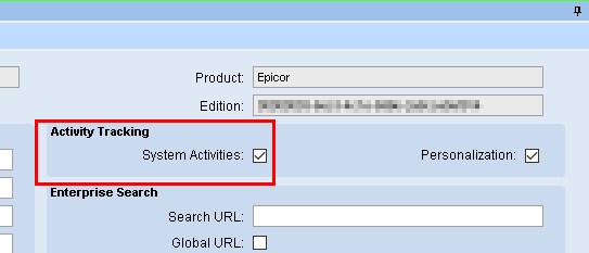

Entries only get added when Logging is enabled in Company Maintenance:

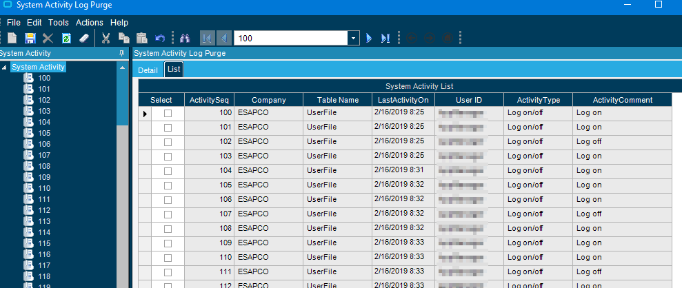

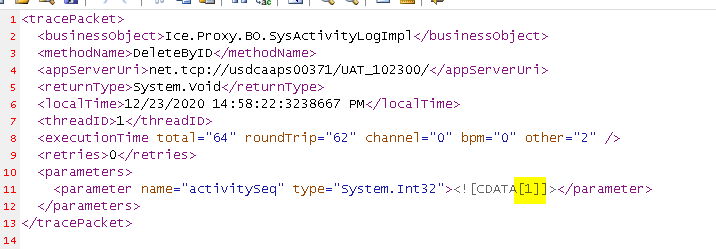

@askulte - I selected the frist 10 Seq numbers (1-10) and then choose “Purge All” from the Actions menu. It created 10 distinct calls to SysActivityLog.DeleteByID()

Thanks. That makes sort of sense… Although my search is ascending, so whatever I enter in the ‘Starting At’ box, I get that, and the records after it, not before it. I’m trying to purge the first 90M (hah!) records. I’ll start with the first 100.

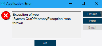

I was able to load 30,000 into the form, using search options. But the Purge All ended up crashing my client. Or maybe I just didn’t let it run long enough. After 10 minutes or so, I terminated the client and
restarted. It showed that only about the first 22,000 records were purged.

The client doesn’t like that many records on any screen, especially if it has to transact on them.

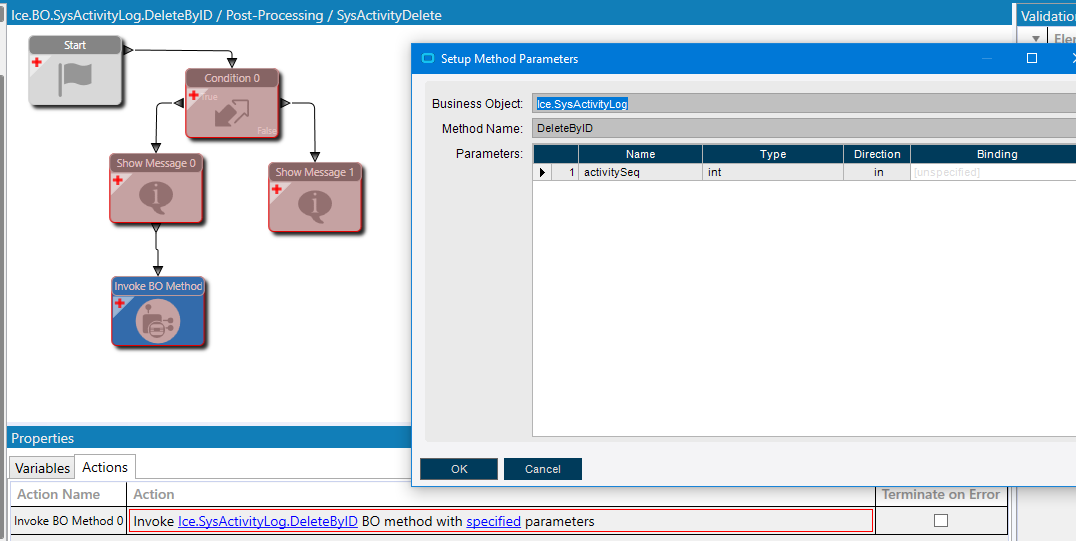

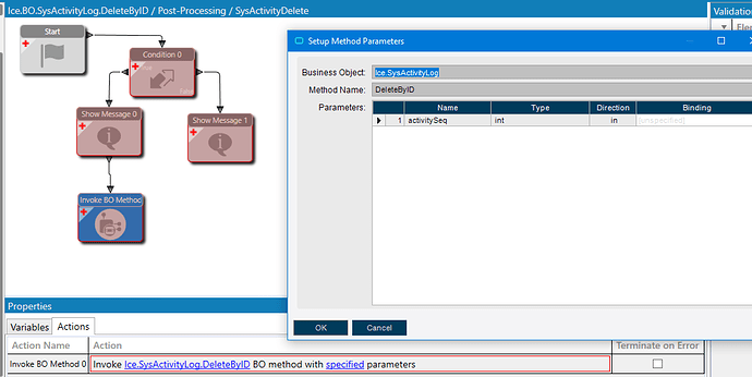

@Jason_Woods - Great idea! But silly question - How? With widgets? Or is C# needed (I can copy and modify code, but not create from scratch yet).
I started a Method Directive Post BPM on SysActivityLog.DeleteByID, but not sure how to trigger it with a condition. I’d like to delete all records that have a SysActivityLog.LastActivityOn date older than “X” (I’m OK with hard coding a date in this BPM…). Or even delete just the millions of bogus LogOn rows from a specific SysActivityLog.UserID would get me 99% there!

500k records:
• Search : 1:27
• Select All & Retrieve: Client closed (crashed) at 2hr13 minutes (Memory up to 2.8GB, 13% CPU)
• Purge All: —
