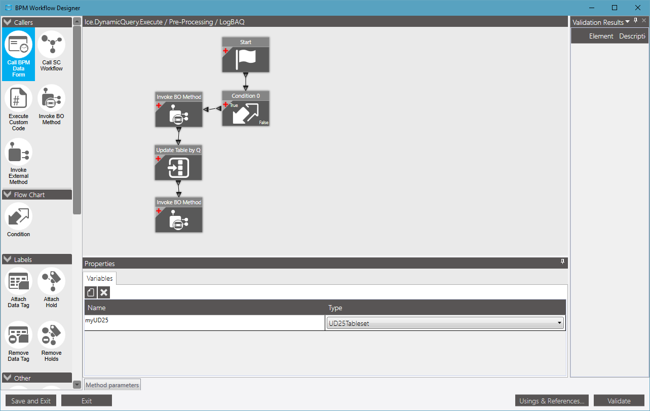

In our E10 system I created a Method Directive on the DynamicQuery.Execute that fires on all non-system BAQ runs that creates a record in the UD25 table which contains the QueryID, RunDate and ClientUserName,
Then I created a BAQ that does a count/group on that table.
I have not got around to re-creating this in our E9 system, it will require some custom code in the BPM which the E10 version does not require. But the flow is still all the same.
I will probably be writing it up in our E9 system so I will post that when its done, if somebody hasn’t done it already. I am pretty sure the BO has changed for DynamicQuery though, and the BPM will probably need to be fired on .Execute and .ExecuteByID in both E9 and E10.

Here is a quick run down of the BPM for Ice.DynamicQuery.Execute (Pre)
Global Variable for UD25Tableset (This can be any UDTable)
Condition 0 : Check if BAQ is a System BAQ or not. We don’t want to log System BAQs
Query for above condition statement
Invoke BO Method : Ice.UD25.GetaNewUD25 method (not sure what the difference between GetaNew and GetNew is) This is where we start to create the log record in UD25.
Parameters for first Invoke BO Method. This is where the variable for the UD25 tableset is originally created.
Next step is Update Table by Query
The query is just the ttDyanmicQuery table (Which is a copy of QueryHdr with current BAQ)
The mapping that is used to fill the myUD25 tabletset from the ttDynamicQuery table we are querying from. This is where we actually define what is in the log record in UD25
The final Invoke BO Method is the Ice.UD25.Update which updatse the UD25 table on the server with our temporary UD25 tableset that was modified in the previous action.
The parameters for the UD25.Update method. This is just the variable object tablset for UD25
