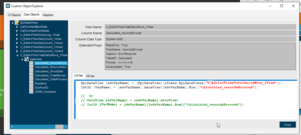

You should be working with the view. You can get the current row by getting ahold of the view and .Row is the current row.

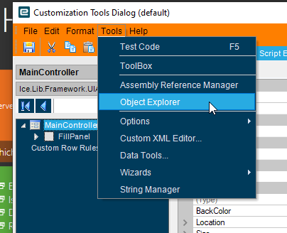

The object explorer has the data views that are available in the customization, and some basic code to show you how to get ahold of the data.
