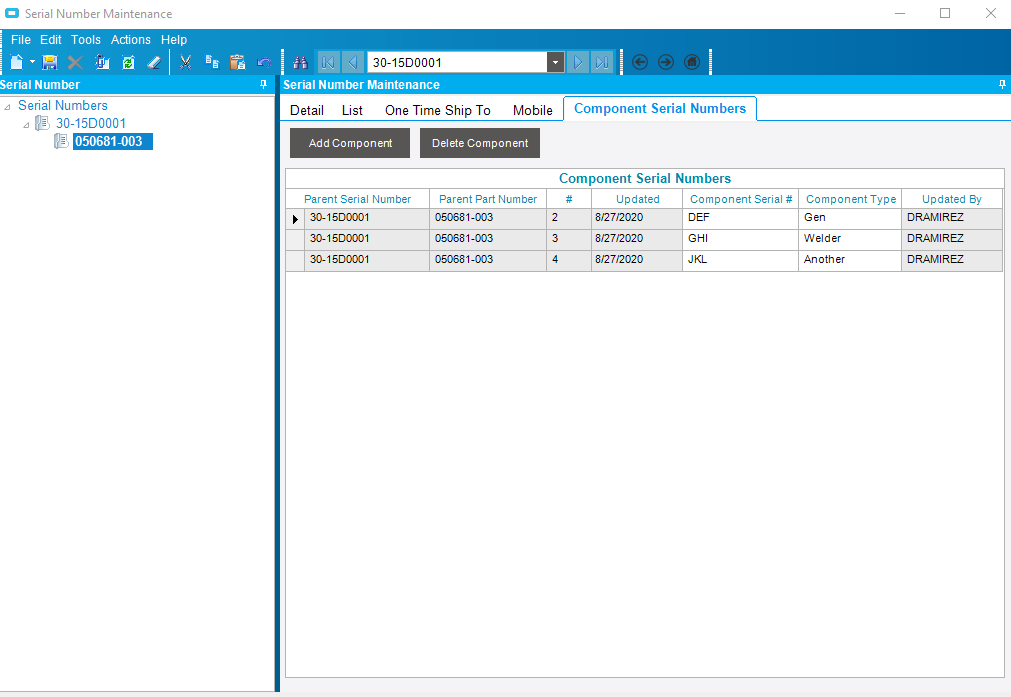

So I finally have something I feel works for our needs. I ended up ditching all the “slick tricks” and just did a customization featuring an Ultragrid with a couple buttons. I modified Extended Properties to prevent directly editing the columns I am auto-populating.
The stock behavior of the Child UD Wizard had a few odd behaviors.It would delete all rows if you did not select any. I think this is because it’s relying on you to hit the Delete button to delete a row… but I added that method to the Delete button I created. So I was able to fix that.
It also would insert a row but not call the method of the GetNewUD13Record() when you hit Enter in the grid - which left a partially filled row that would never save. So I added a Cancel to the beforeRowInsert event and then called the GetNewUD13Record() method. Now when you hit Enter, it acts just like you would expect.
