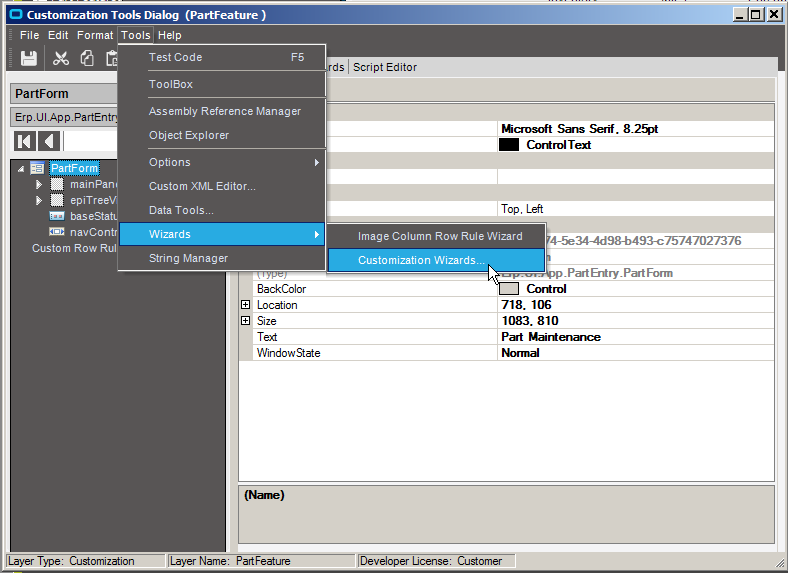

Nevermind, I found it in the Customization Tools Dialog under Tools > Wizards > Customization Wizards. How about that?
In the customization go to Tools -> Wizards -> Customization Wizards.
Then select Add User Defined Table As Child
You’ll have to select your parent and child views and then define the key that connects them.
