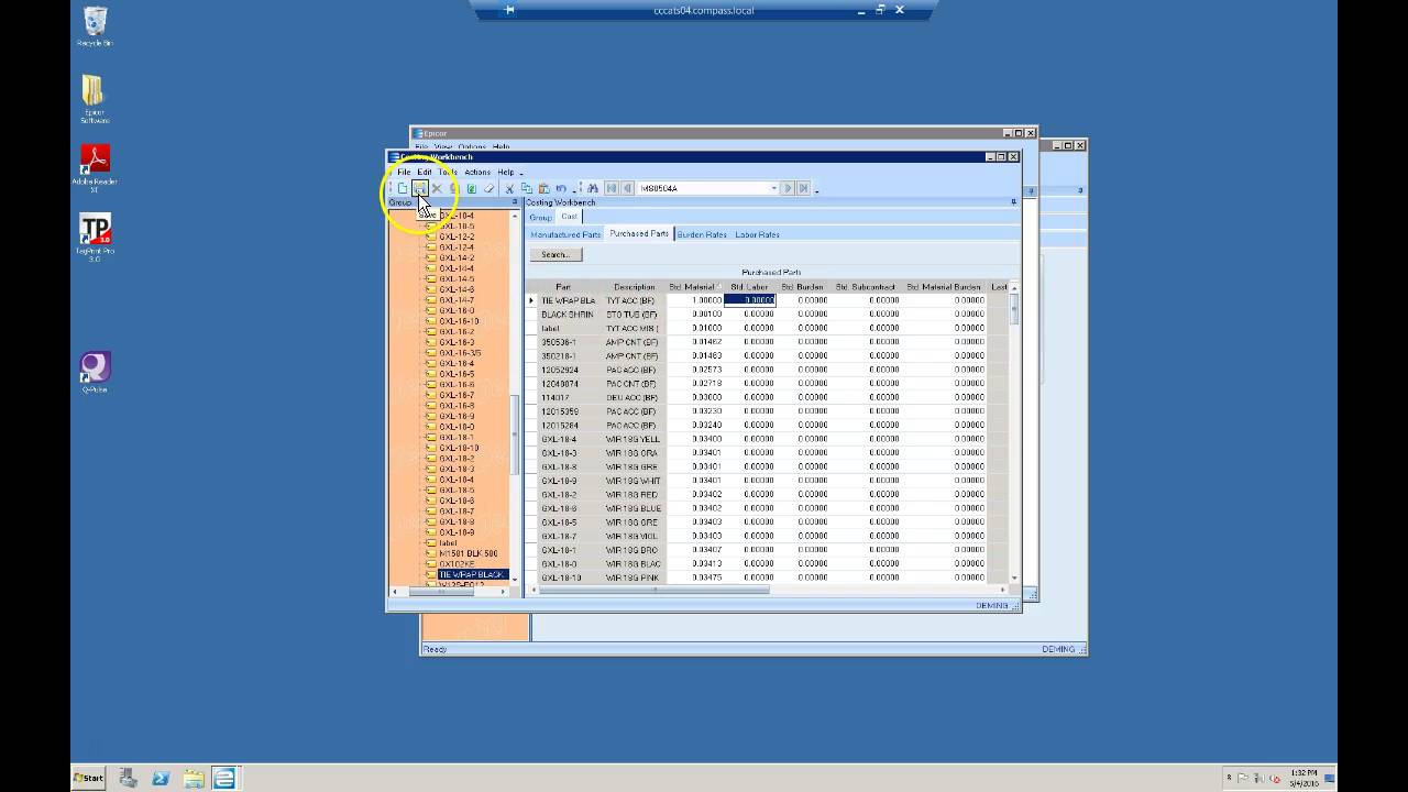

Costing Workbench This will rollup costs such as material and labor/burden. If the material is not rec’d yet, it wont have a cost. so you can edit it in CW temporary or do cost adjustments for the parts before CW.
Is Costing Workbench just for standard cost though? As we’re average cost we dont use it (should we?)

The video you include in this email was helpful. I follow all the steps on the video, but when
I do a job none of the cost of the new parts print on the job. We are set up to use FIFO as a cost method. I set all part to FIFO and all show FIFO. This attached is our cost adjustment, could you please help me, and could you tell me how can I get the cost on AVERAGE/LOT AND STANDARD to show on the last column On FIFO AVG/LOT. I think that this is
What is preventing the cost to show on our job.
