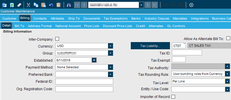

And setting the Tax Liability for the Customer, just automatically sets that as the Liabilty on new orders. Adding new ShipTo to the customer sets that ShipTo to the same liability as the “main” customer settings. Be sure to update those if they are different than the main.

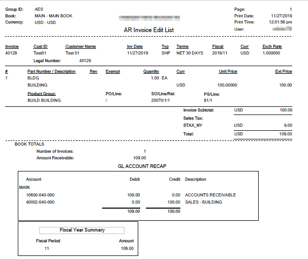

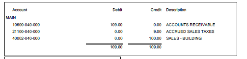

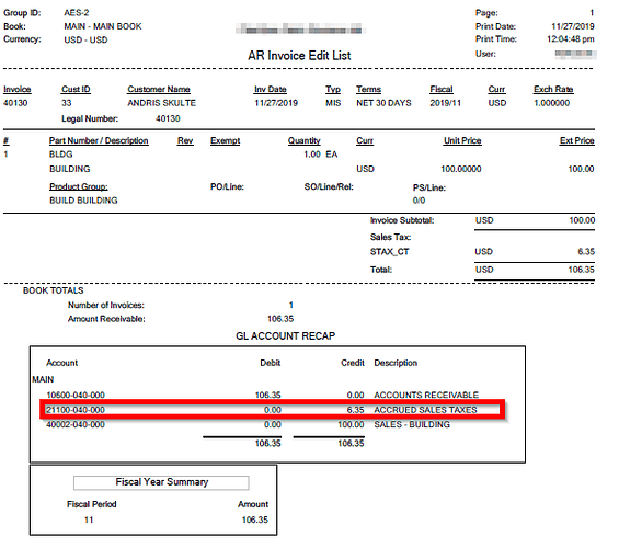

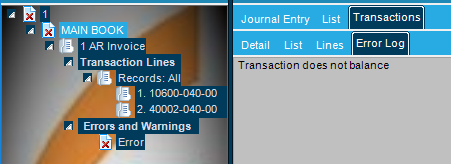

Exactly! I posted just to see where they went, and it got sent to the review journal. I went back to Tax Type, added the TAX > SALES TAX GL Control, cancelled the RJ, and recalculated tax on the AR Invoice. It worked.

Looks like that “IF” isn’t happening, or the result of the Master--GL Control is also not valid.

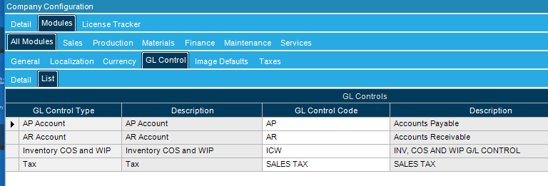

If the GL Control for the GL Type of “Tax” was previously setup and assigned to the applicable Epicor company on the Company Configuration screen, it defaults into all NEW tax types that are automatically created by Tax Connect on the Tax Type Maintenance screen when tax calculations occur for the first time for the applicable tax jurisdictions. The Epicor company’s GL Control for the GL Type of “Tax” only defaults into Tax Type records as they are created by Tax Connect.
A/R invoice groups cannot be posted until the applicable GL Controls have been setup. For invoices and credit memos in the group which reference tax types that are for tax jurisdictions that you have calculated taxes for before , Epicor will try to obtain the GL Control from the applicable tax type record(s) on the Tax Type Maintenance screen. For invoices and credit memos in the group which reference tax types that are for tax jurisdictions that you have not calculated taxes for before , Epicor will try to obtain the GL Control from the GL Type of “Tax” from the Company Configuration screen for the applicable company. If in either scenario at least one GL Control has not been setup that is needed to post a transaction in the invoice group, a Review Journal will be created and the invoice(s) will not be posted since the GL impact is out of balance due to one or more tax-related GL accounts and amounts missing due to the missing GL Control. The invoice group remains (is not deleted) and the invoices in the group (and/or the group itself) show a status of “Reviewing”.
