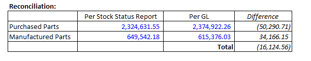

Does anyone have an inventory report that they run at month-end to tie out to the GL for inventory? We run the Stock Status report and it does not tie due to capturing monthly. Do you make a journal entry on a monthly basis to tie out the GL to the Stock Status?
Below is a reconciliation of our inventory GL to Stock Status.
This comes up all of the time and the Epicor response is that you cannot do it.
That being said, what costing method do you use? Do you use lot or serial tracking?
We use average costing. We do not use lot or serial tracking.
What are other companies doing to tie out inventory? Do you make a monthly journal entry to tie out to the Stock Status report? I would think that report would be the accurate value of inventory.
