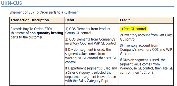

Ship 920457 to a customer (UKN-CUS): Part GL if any, then Class GL

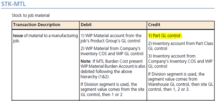

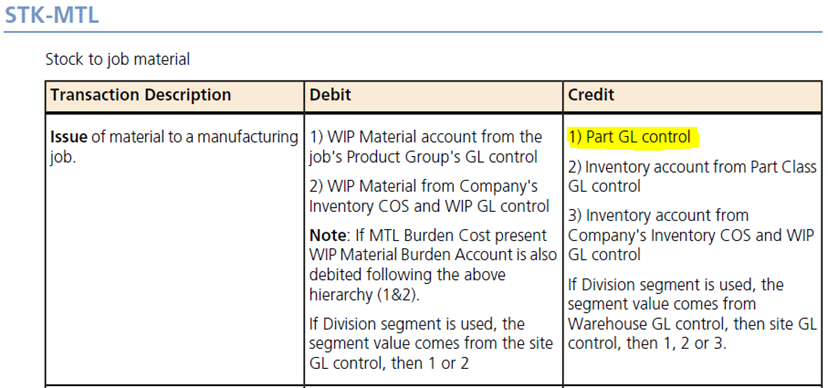

Issue 920457 to a job (STK-MTL): Part GL if any, then Class GL
(There is no UKN-MTL, by the way; STK-MTL is used even for non-QB)

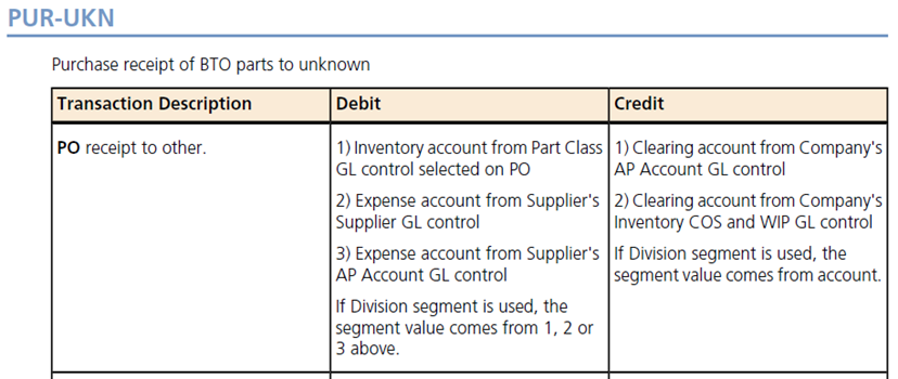

Buy 920457 on a PO (PUR-UKN): Ignore Part GL and start with Part Class
Well isn’t that something else. We are buying this part into a different accounting bucket than we are issuing it from. #LearnedThatTheHardWay

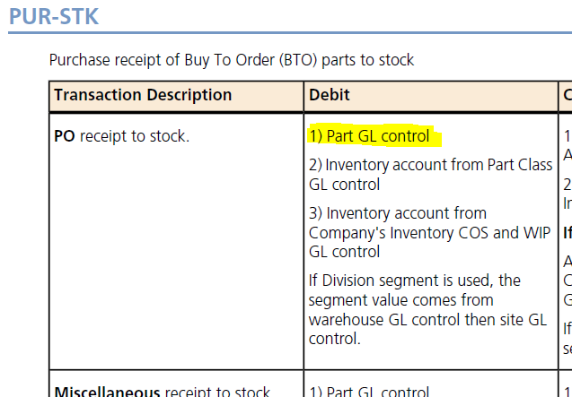

(FYI, PUR-STK looks at Part GL, then Part Class.
