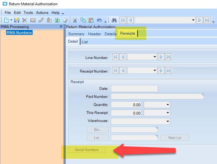

We have serial tracking of parts and we also have RMAs. When you do the RMA are you receiving the part, with the serial number, via RMA receipt? After that, are you doing RMA disposition to stock, and selecting the serial number once again? If your serialized part is in stock, upon customer shipment the system should request a serial number and the one on your returned/stocked part should be available to select for shipment.

We do the RMA as you describe: RMA with serial number, Receipt with serial number and disposition with serial number and send the part to stock. If you try to create the RMA without SN, in case the part is serialized the system ask you for the SN and doesn’t let you save the RMA. If you track the serial number the tracker shows the it was sold to the customer that returned the part and makes reference to the RMA.
