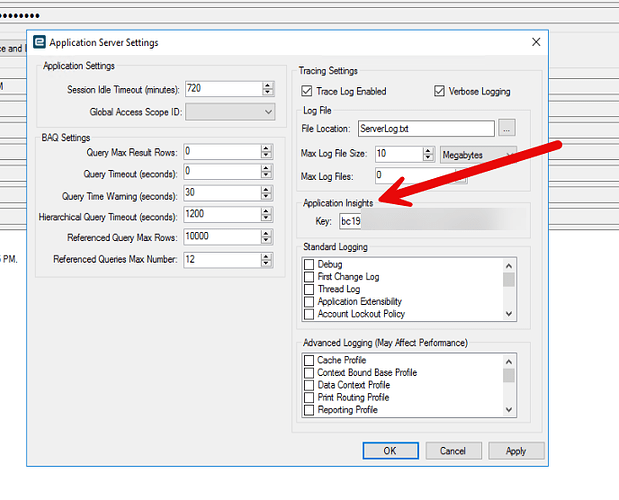

I haven’t tested this but you can now update the Application Insights Key in App Server
Would this accomplish that?
