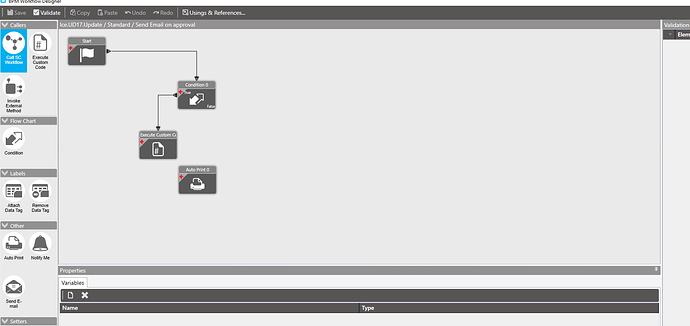

Dear All, i need to Trigger a Data Directive BPM when the user click on a button in customization,
all i need is to know the code.
A data directive is triggered in a data save so change / save some data

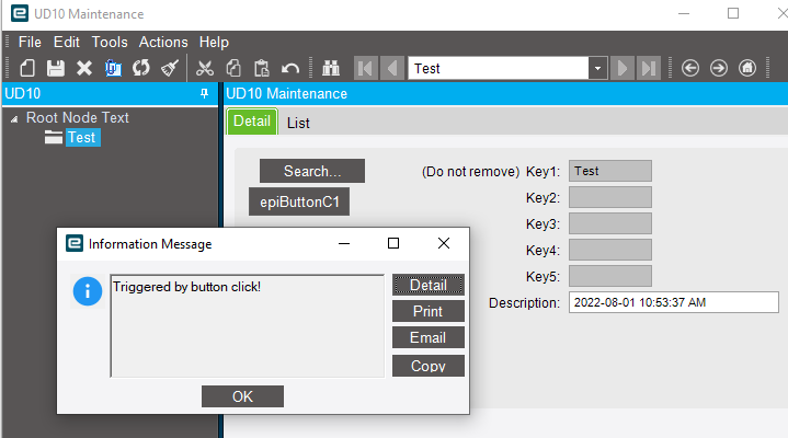

Anyway, you could assign an unused field (or better a custom UD field) to force the data directive to fire (you could use a timestamp)
private void epiButtonC1_Click(object sender, System.EventArgs args)
	var ud10View = oTrans.Factory("UD10");
	ud10View.CurrentDataRow["Character01"] = DateTime.Now;
	oTrans.Update();
You could set it back to blank in the data directive.

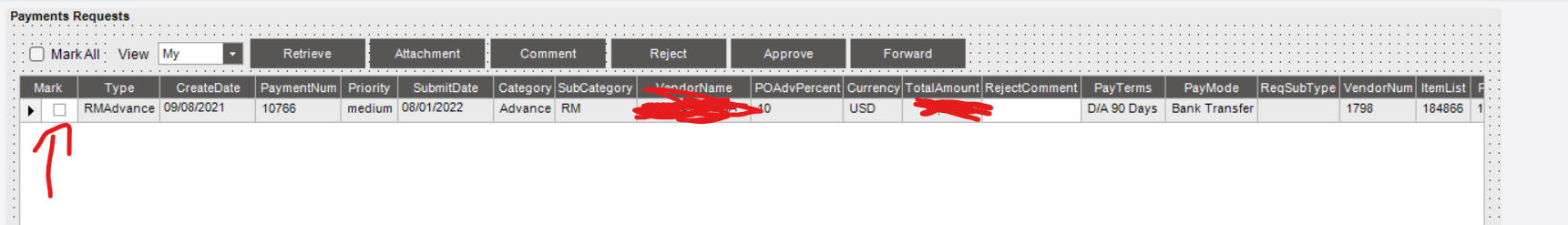

the problem is I’m choosing data from the grid I’m not selecting or getting by ID
so i need the code how we can get by id data and update it
