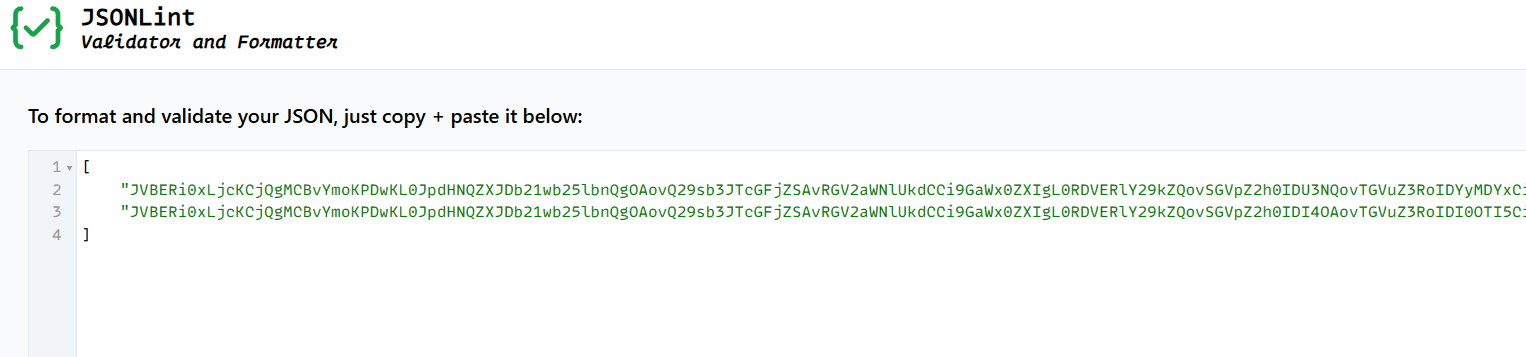

One returns a DataSet with some PDF Data in Base64 format.
The other is just a little helper that retrieves the Base64 Data from the Notes Section in the function.

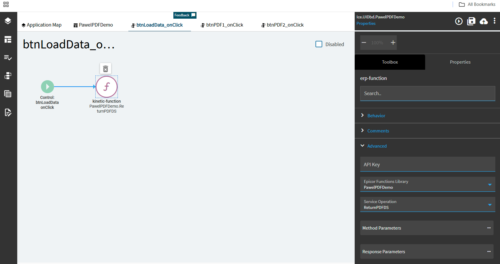

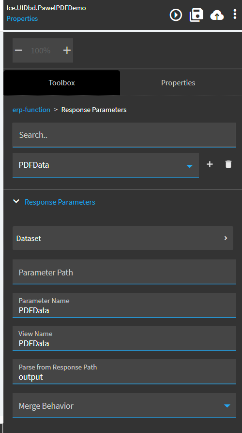

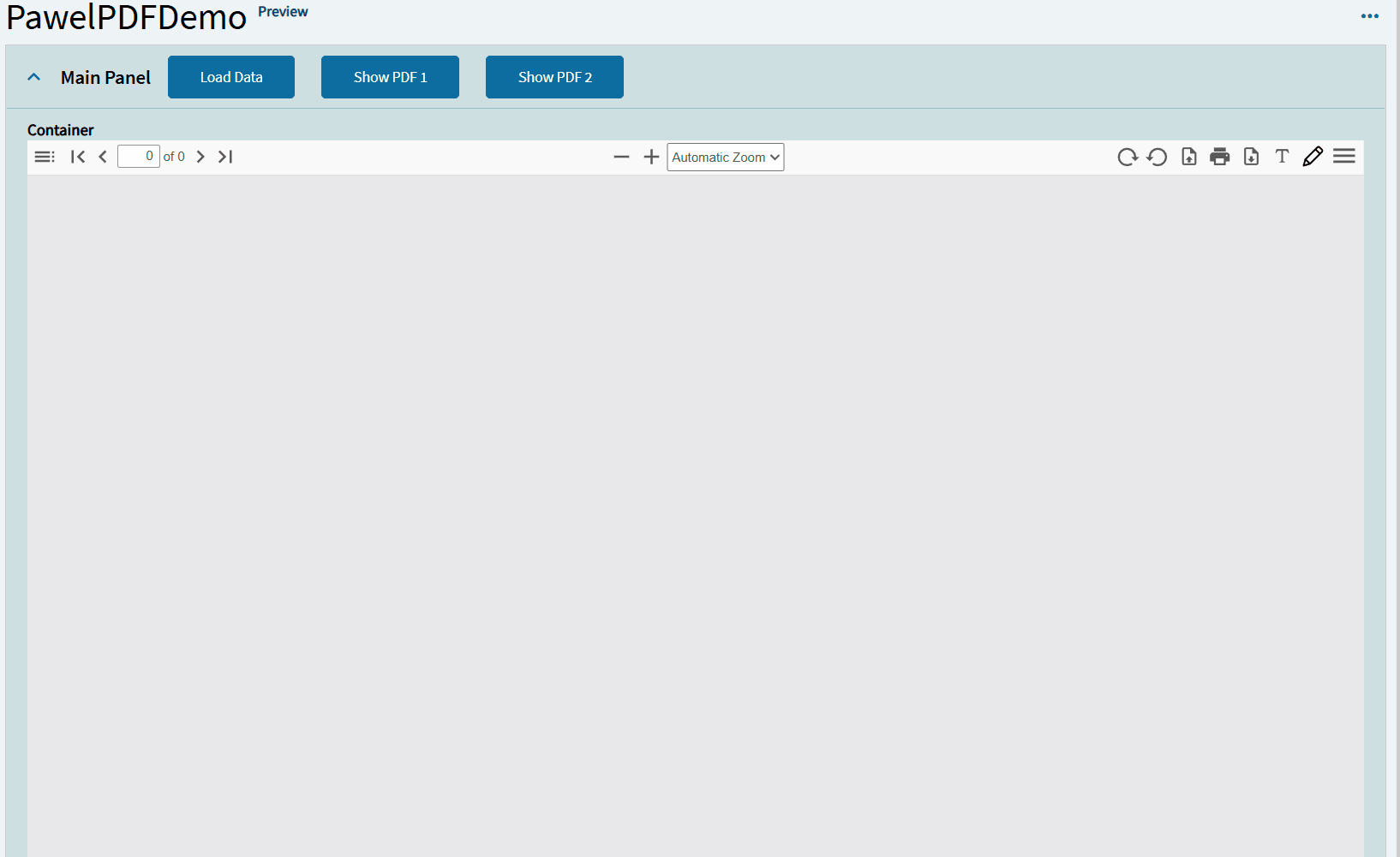

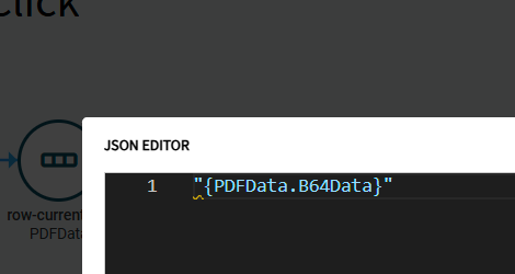

Kinetic App

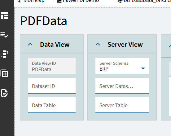

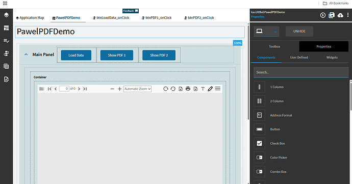

Set up a Dashboard like this
Added a DataView

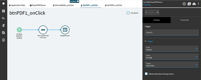

Load Data Button

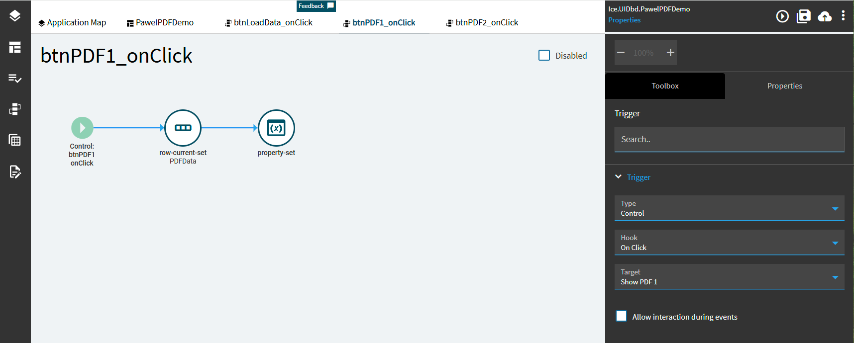

Load PDF1 Button (PDF 2 is the same)

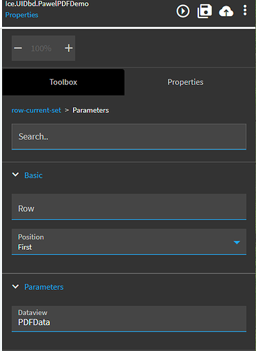

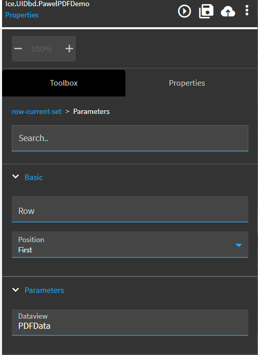

row-current-set
- PDF 2 will be
Last(we only return 2)

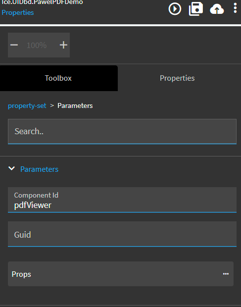

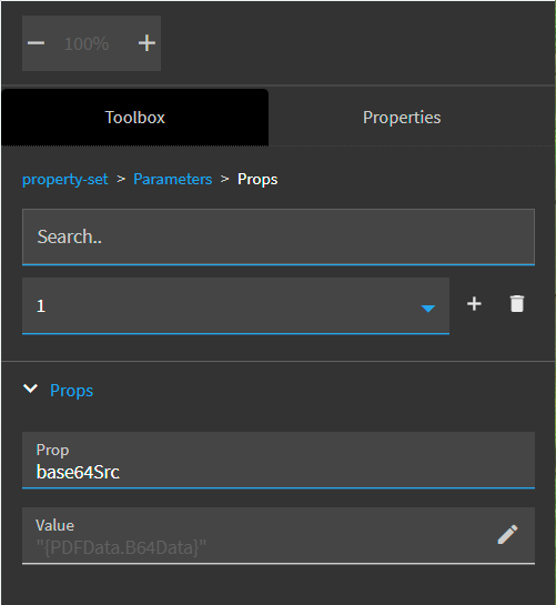

property-set
