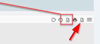

It would be nice to see how this widget was built because it seems like we would need access to the “src” property in order to dynamically load PDFs in Kinetic. I was hoping the epBinding would do that, but it doesn’t seem to be the case.
Well, this is kind of neat. If the PDF has form fields, you can set the epBinding of the pdf-viewer to an empty dataview and it will load the fields for use if needed.

But it looks like it serves up a fillable PDF. Which would let the recipient make edits.
Any thoughts on how the downloaded PDF could be made read-only?
(as much as an unsecured PDF can be)
