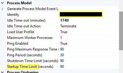

I typically see it when the server is restarted, and my test server is very slow.
Could be this too in IIS
EDIT:
Doubled my value to 180 and fixed my issue.
I’ve restarted the app pool several times. 2022.2 works fine with the same app pools. But 2023.1 won’t start. I hadn’t tried changing the startup limit as we’ve not needed to do that before. I tried 180 and 300 and same result.
